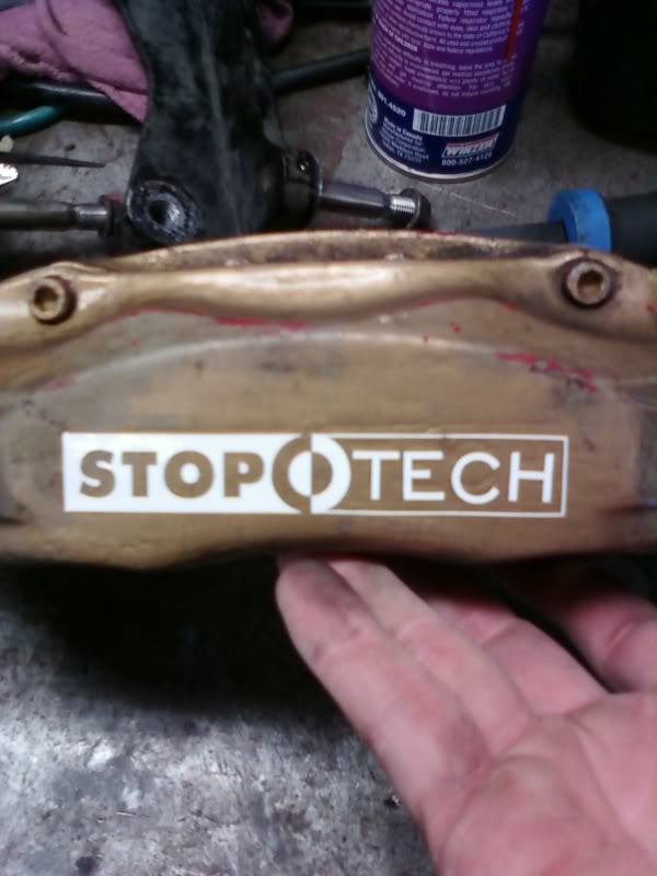

Here you go Dave

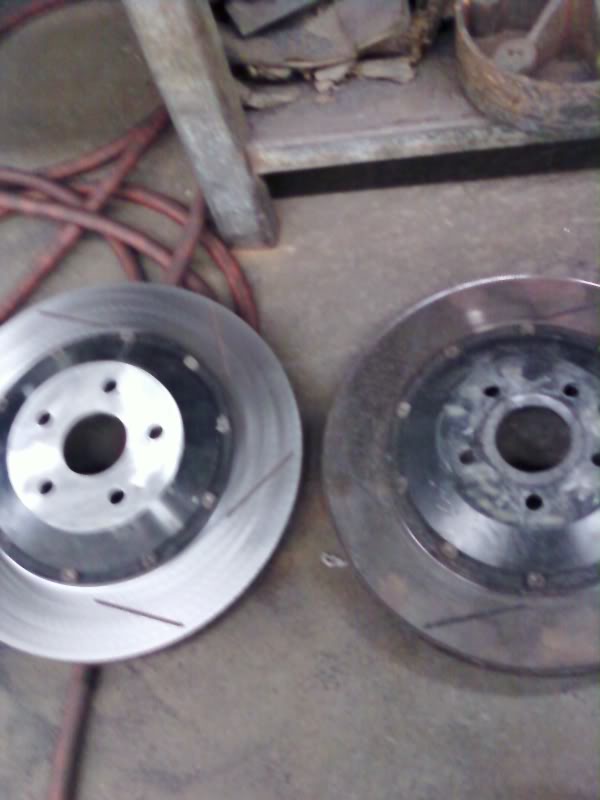

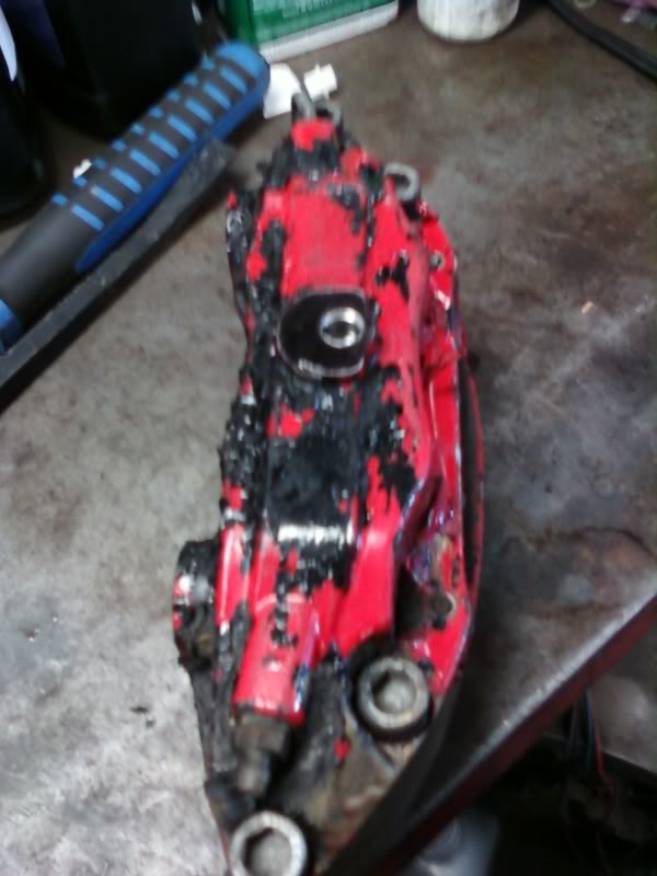

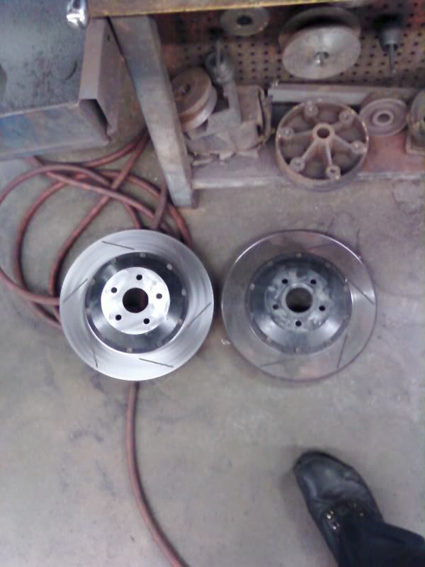

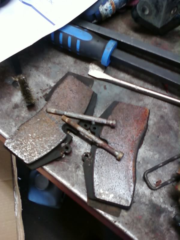

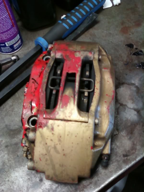

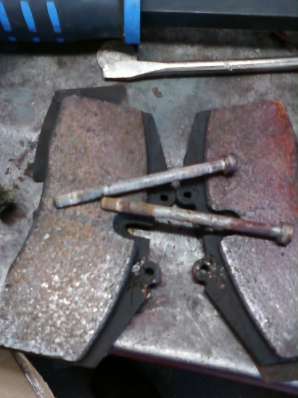

BBK Update: Well I have everything disassembled. I resurfaced both rotors. I polished all of the bolts, pad retainers (rectangle metal ring), and lines. I had to use an easy out on one of the bridge bolts since it stripped out, but I will have another one on the way (only $1.50 for the bolt). I also couldn't get loose any of the torx bolts for the pad guides out so I will either A. Sand/clean them up on the caliper and mask it off when I powder coat or B. Use an easy out on all of them and replace all of the bolts. I think I will do B since I want to get back behind them and powder coat behind them, one of them looks pushed out from corrosion or something. Here are some pictures.

^^As you can see in this picture, the caliper mounting bracket studs are polished
As you can tell, there is a night and day difference after the rotor is resurfaced.
I have put a lot of hours into this project already, and many more to come! Next up is media blasting, prepping, more prepping, pre-baking, and finally powdercoating! Then new dust boots, piston seals, and other misc. hardware. What do you think? I wish I had more after photos, but I promise some good finished product pictures to show what the outcome looks like.
