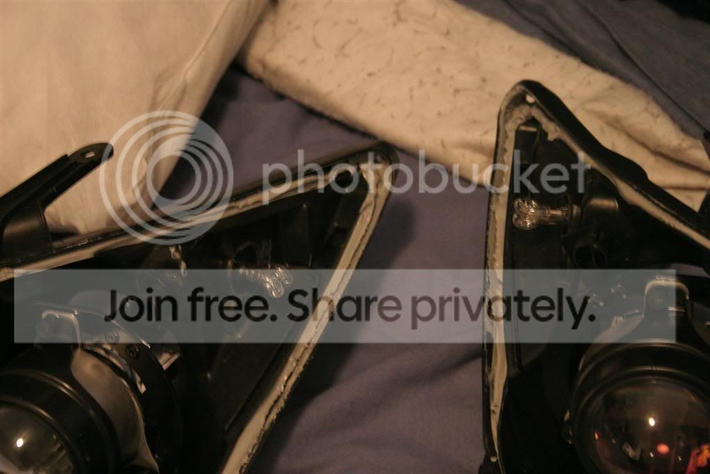

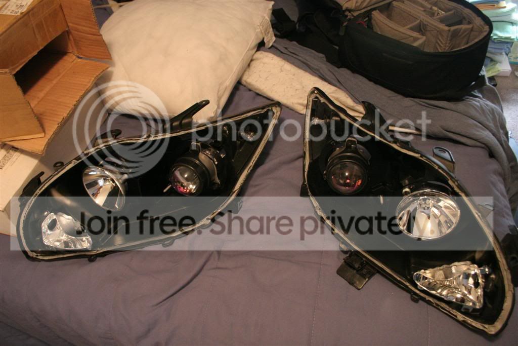

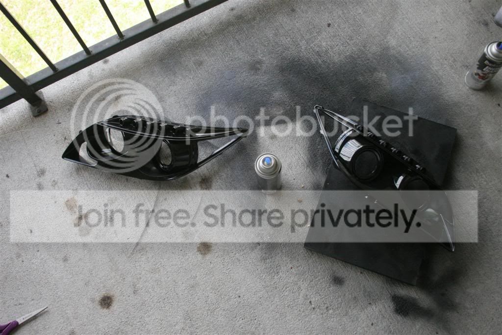

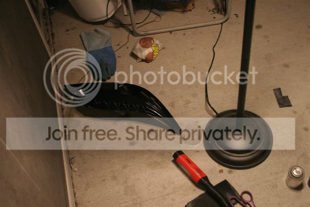

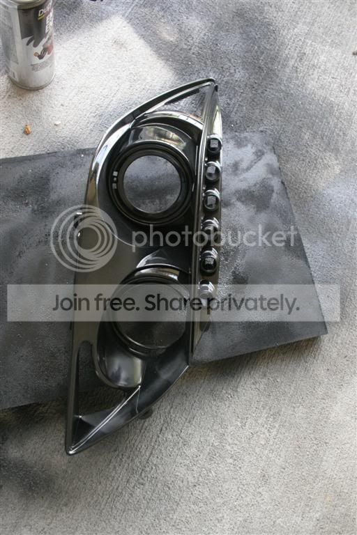

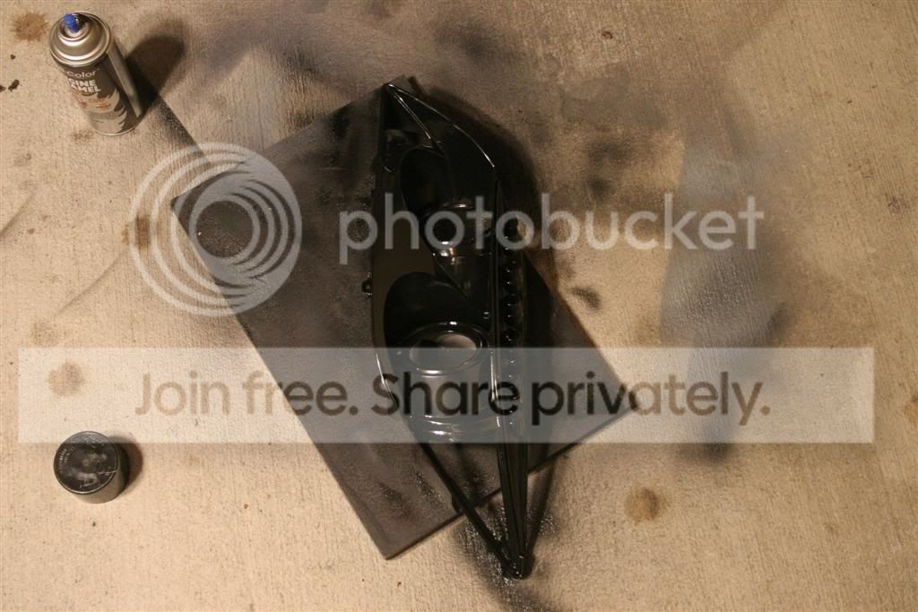

glossy black anzo's...
1-
2-
that's about all for tonight (maybe)... running out of light and stuff to see paint coverage with. might go get a lamp lol.... but yeah, everything is looking good. I had a little issue with the primer, but some sanding and such later, it's a-ok. each bezel has 1 paint coat on it, i want 2-3 for good coverage, and then another 2-3 of clear. should be assembled by tommorow night. keyword, should.

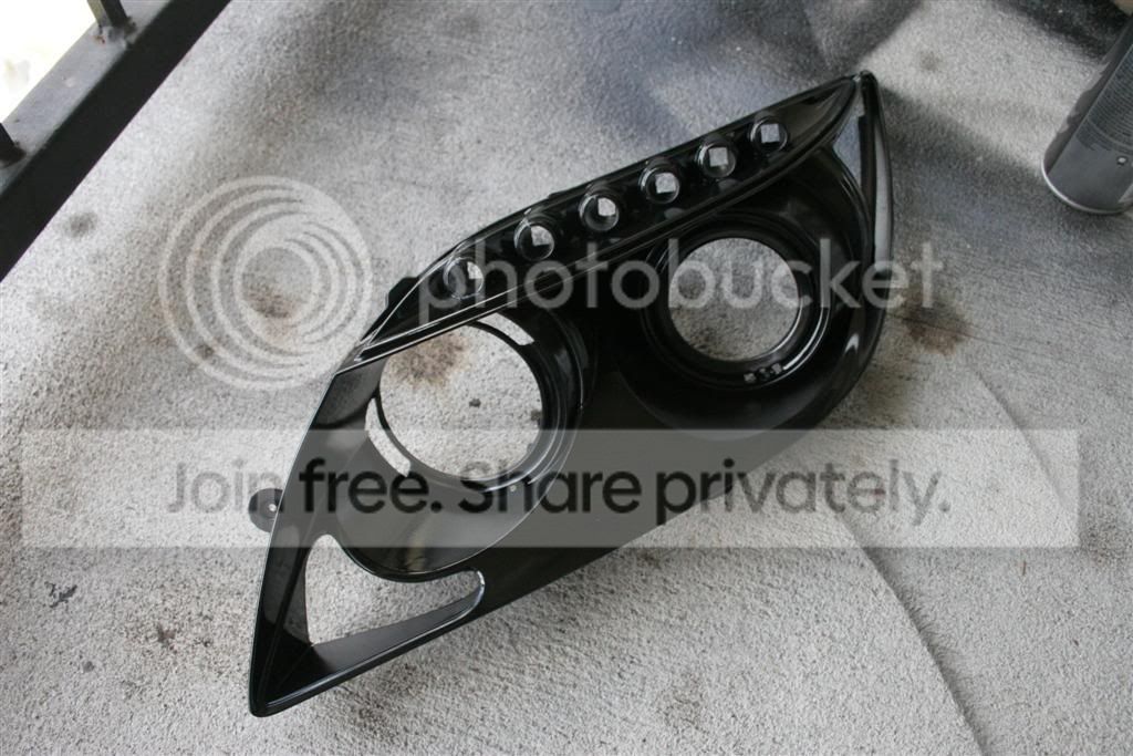

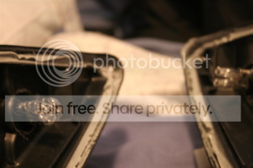

yeah... projector housings... what's so special?
well... let's look a little closer-
yeah.. whelen strobes in the sidemarker slot-
housings fully clearcoated and drying-
