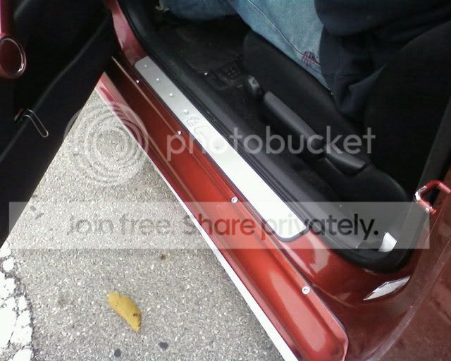

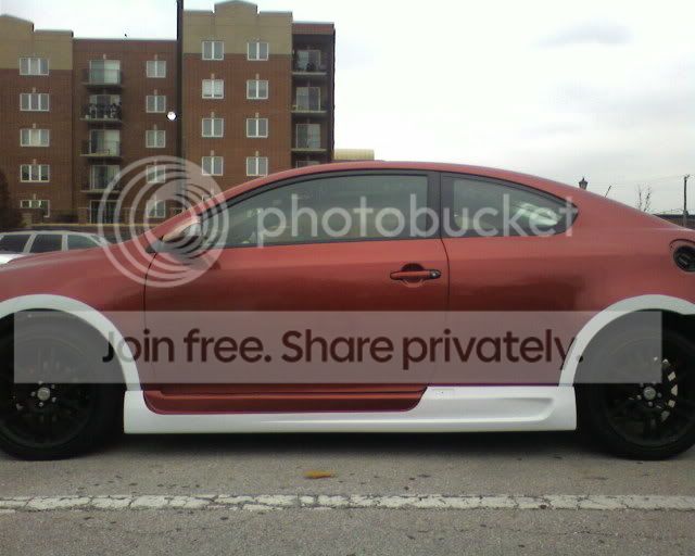

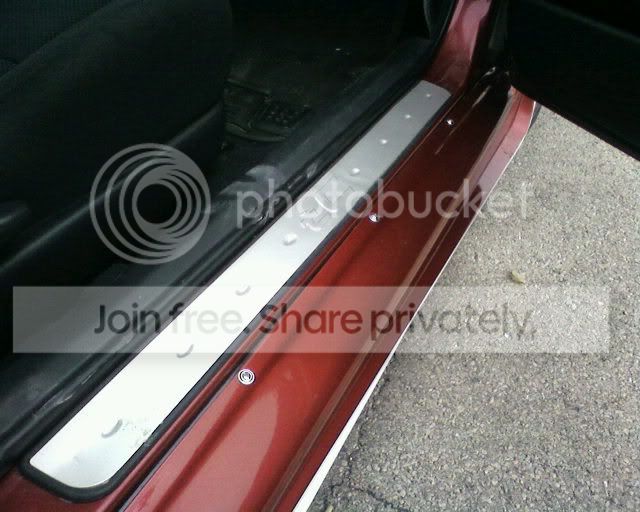

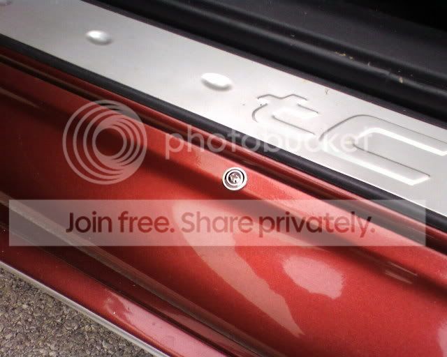

Im not going to start a new thread about this because I dont have pics of the how to but I have example pics.
Ok well for those of you with Kaminari side skirts, we all know they fit great but don't quite fit perfect when it comes to the door jam just like the rest of the body kits out there, nothing is perfect. But there is such ting as close to perfect and doing this just takes you one step closer.
I have the authentic discontinued kaminari fiberglass sides so I have a much better fit and defined shape but mine are allot easier to brake so those of you with fiberglass be careful because you can crack them and split it as easy as wood. You want to first drill a hole with a drill bit just smaller than the screw you are going to use and drill through that but not through the stock side skirt because thatl weaken the hold. When you put the screws in make sure they do what you want them to do but dont put too much stress on the side skirt because if theres too much tension eventually the fiberglass will give away and crack. I put mine like this, not in the center because then theres very little fiberglass holding it from pulling away.
Like I said I used chrome finish screws so it looks good, at first I didnt like that I had to do this but now I do like it because it matches the door jam scuff protector.
On the other side I only did 3 because there would be way too much tension at the far left and it would eventually brae though, so I just put them there to keep it from wiggling.
Those of you with poly kits its alot easier because they wont give away lie fiberglass, so you can pull it and put pressure on it and make sure you have it fastened to the old side skirt so that it doesn't pull the screw out.

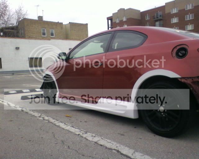

And a sneek peak! Even though its not a perfect fit near the door jams its a great quality product so if anybody wants it and is questioning the fit dont question it because I never herd of anybody having fitting issues with Kaminari. But the fiberglass version has a much better fit than the poly because the fiberglass can tae the shape, the poly is like a rubber so it kind of gives it a smooth shape on the corners and because of that it mostly just covers the shape to a dull tip instead of detail. Still great though!
