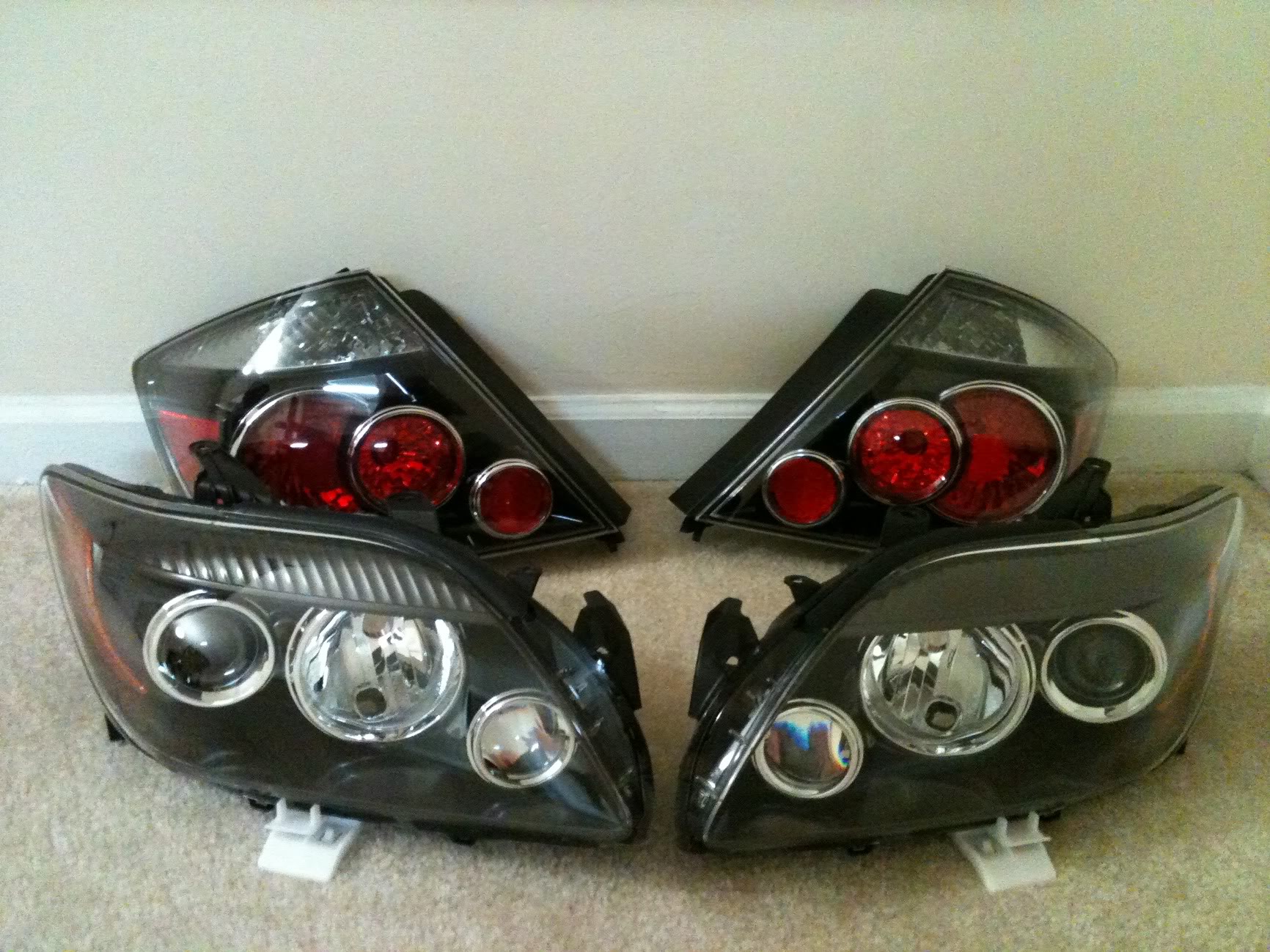

I never got a definitive answer from searching but consulted with The Retrofit Source before I ordered anything. They recommended the Morimoto H1 kit and the extended E46 shrouds. They told me there would be no cutting so I went ahead and ordered them and they arrived on Monday.
After baking them and making my whole house smell like carcinogens, my lights were opened and my friend Ernie and I began the install. Unfortunately, the threaded shaft was a tad too short and I did end up having to cut one of the inner rings of where the 9006 bulb mounted. This opened up about the 2-3mm I needed to get the lock ring on. Besides this one little modification, the kit installed rather smoothly. The E46 extended shrouds were perfect and made it almost look OEM (it would have been even better if I didn't get a little bit of sealant on one of the shrouds. I was too lazy to open them up again to clean them off and if you're looking that hard to find imperfections, you're just an _______ anyways).
Light output is much better than the HIDs I had in the reflector housing. Install was pretty straight forward beside the slight cutting. Overall, I would have to say that the kit recommended by TRS is great for people like me who did not want to make serious and irreversible modifications to their headlights.
I don't know how to hotlink with google, so here are a couple pictures I took after getting to work today. I need to take the bumper cover off again and realign it, after that I'll take better pictures with a real camera.

Lookin good! Now you just need cut off shots and night shots!
I've been seriously contemplating getting a set of these. They're the easiest install retrofits around and from what I've heard, the output is excellent. Can't wait for "real pictures"
You stick with the 4300K HIDs or did you do the 5200K?

The shrouds fit perfectly without modification!
