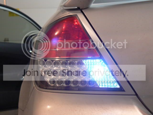

sweeeet. got any pics of them?

Not sure why picture of back up light turned out blue. They are actually more white with a hint of purple. Maybe I'll try a shot from further away or fiddle with camera settings! Don't expect the light output to be better than the stock bulb. This is a 9 LED bulb which I plan to upgrade to a 18 LED SMT(a little pricey) 921 bulb shortly.
