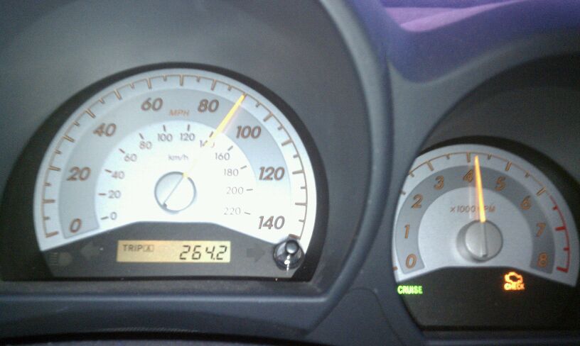

So I was off by a bit I know its an odd angle on the each but its just above 4k. You guys can ignore my cel too :p
