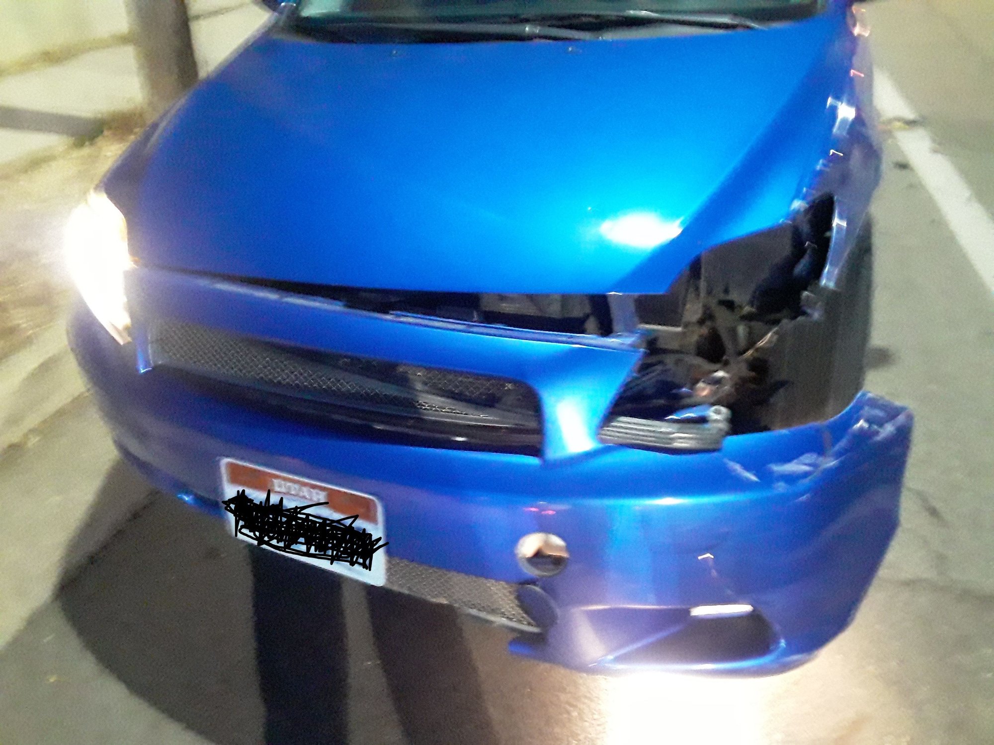

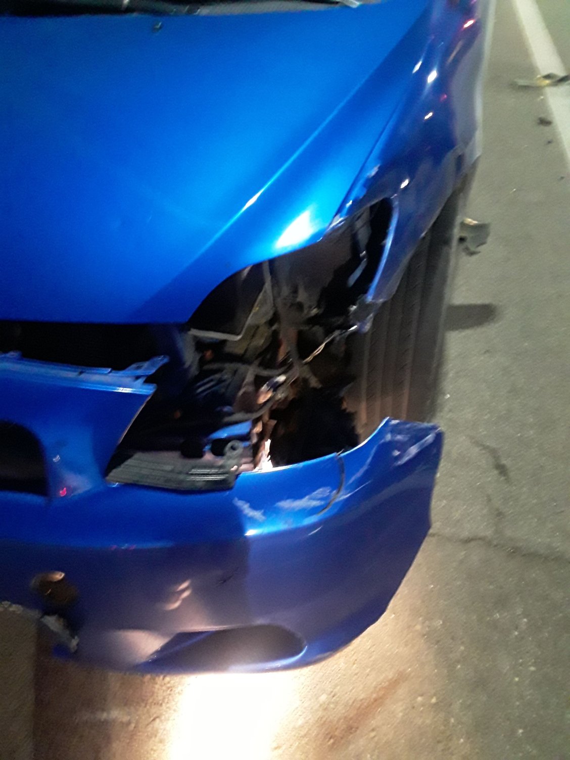

here are some pics of the initial crash
I'm gonna take some more tonight
