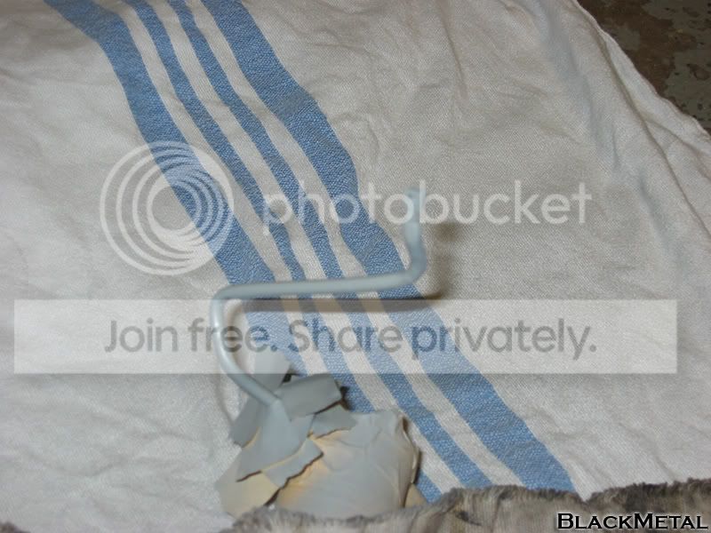

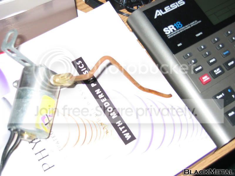

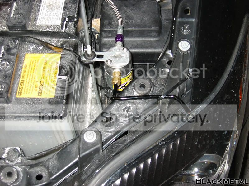

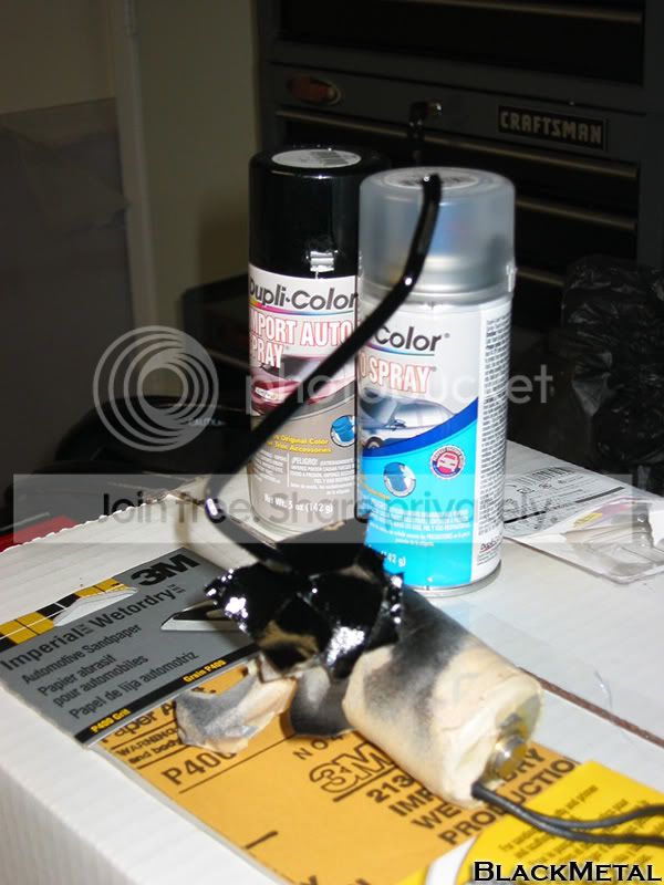

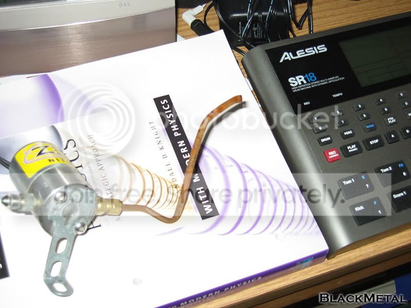

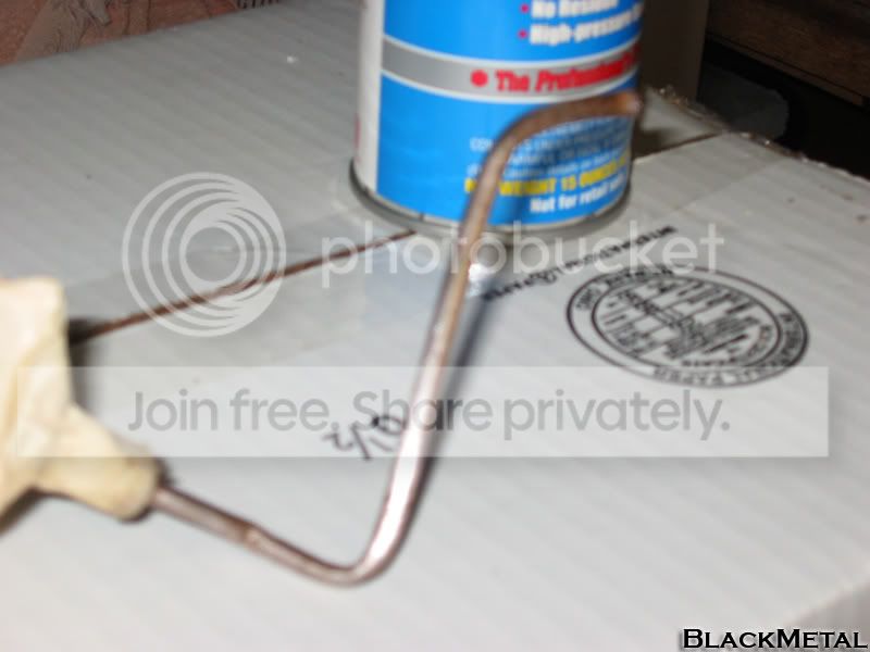

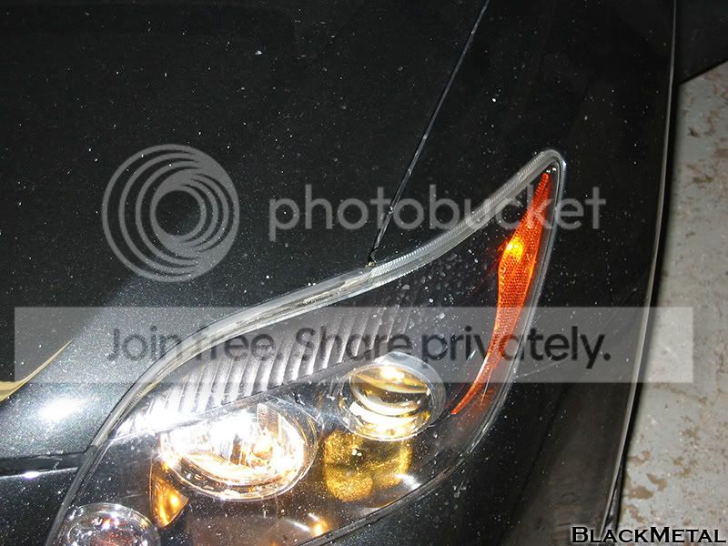

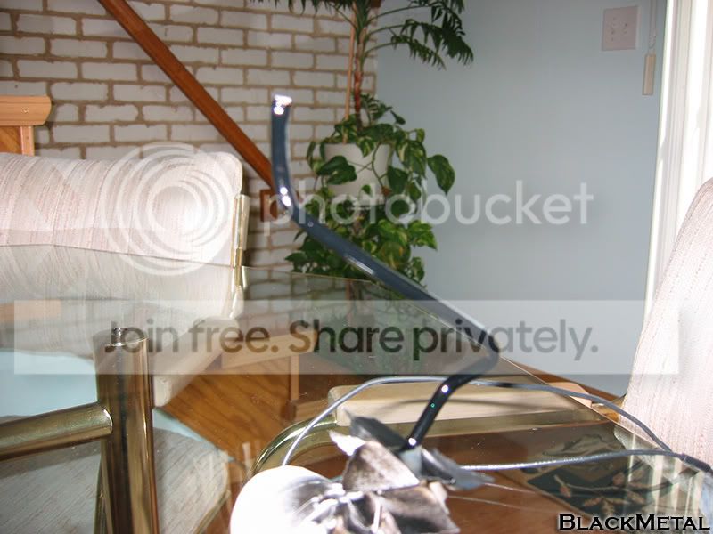

Figured I'd do a little update... My purge pipe rusted badly so I decided to sand and paint it... I should have done this from the get-go, but it finally got to the point where I couldn't stand to look at it anymore... Not to mention that even before it rusted the little bit that was sticking out between the hood and fender looked horrible...
Rusted:
Started sanding with 400 grit:
Primered (Stuck a Zip-Tie in the hole to prevent it from cloging ):
First coat in black:
Third coat in black, and after some cure time the first coat of clear:
Third coat of clear, and 48hrs cure time... Installed on car (Zip-Tie keeps it from banging around durring purges):
You can barely see it with the flash... If you were just passing by you'd really have to look to see it now... So much better than before ...
