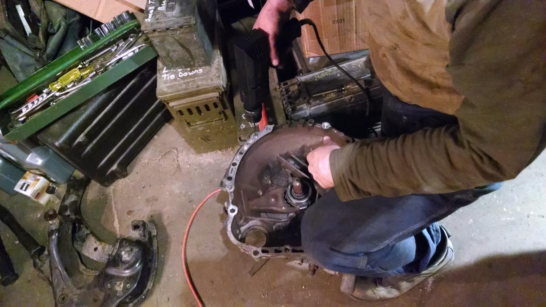

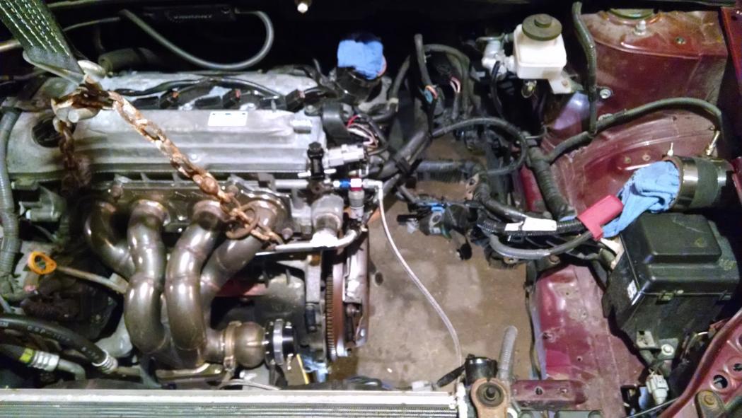

Rear mount press bolts were stripped by the shop that replaced the motor. I had to weld the head of the bolts to the mount and ground them off once they were out. Also snapped a bolt in the bell housing. If this was newer and didnt have 6 winters on it, it would have been much smoother. We bolted everything up with no problems once we got past the issues. As you can see, the turbo F'ed up that stock clutch. 5k on the clutch and she was friiiiiied.
