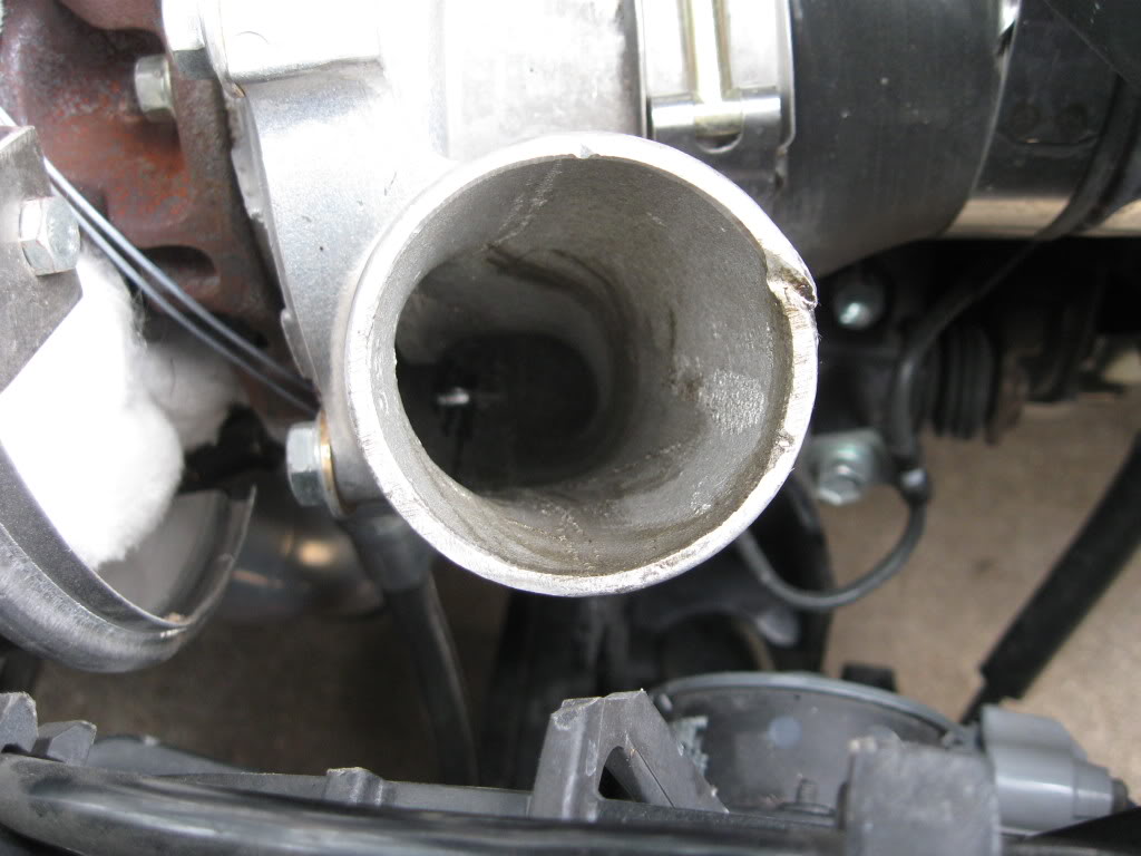

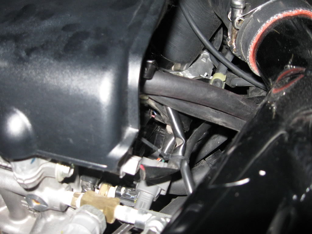

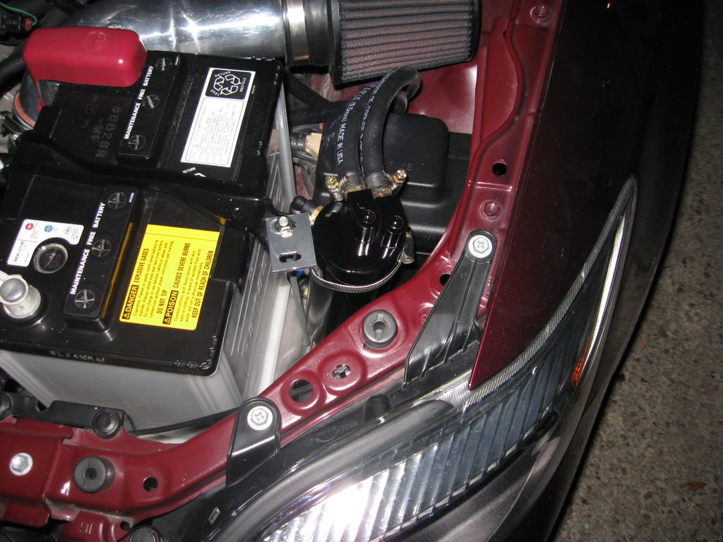

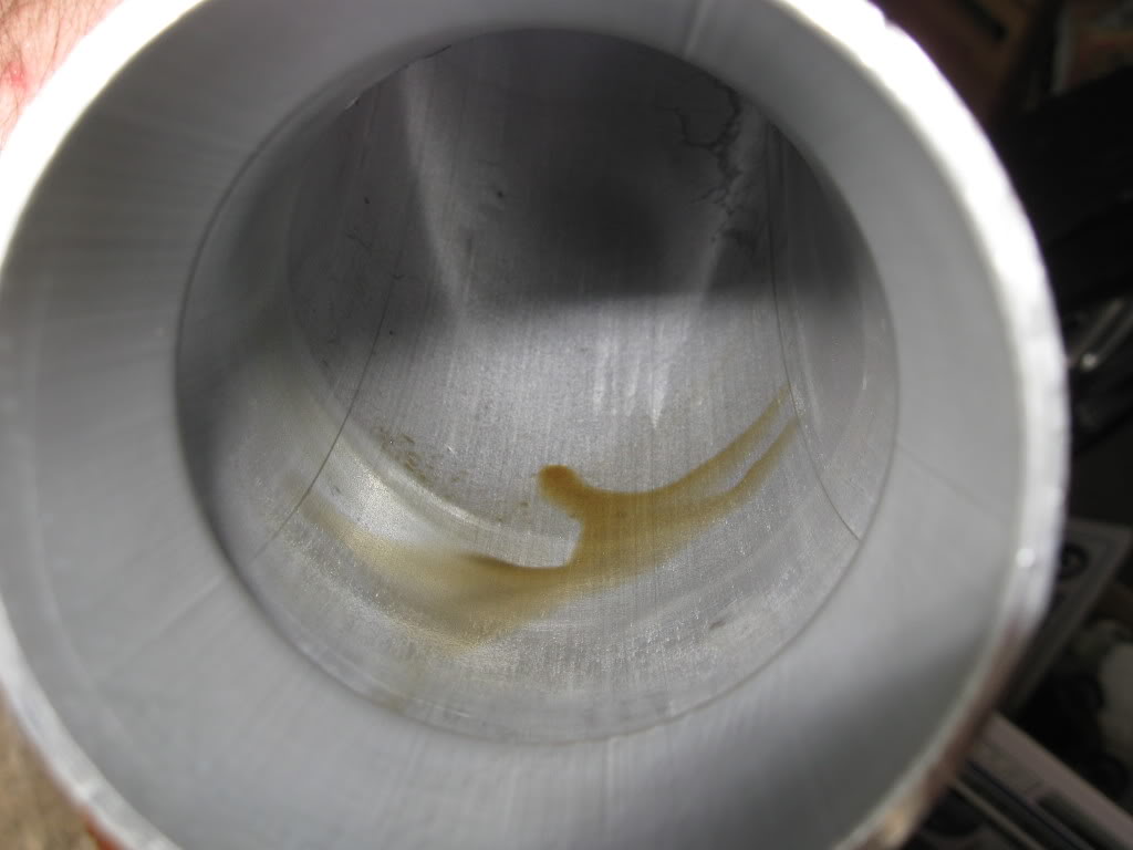

iv owned one that i got from ebay...i had heard that they leak pretty bad so when i got mine i took it apart and compleatly sealed it up...never leaked but never cought the oil either...the input and output are soooo close togather that oil just passes through, they are also not baffled so go figure.
imho its too much bs work to make it work properly. first you have to take it all apart and seal everything up with some teflon tape (dont trust the gaskets that come with it) and then you need to rig up a tube thats connected to either the inlet or outlet that will fit inside the can. this way atleast it has a snowballs chance in not allowing the oil to just pass through.
here is some pics of mine (i sanded it and painted it black)

intake side
head side

the results
(inside the turbo intake pipe)
(some residue made its way into the turbo)
