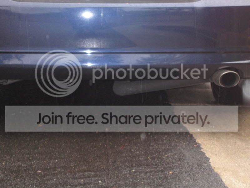

GO CUSTOM!!!
i went with a magnaflow muffler in place of the stock resonator location, and straight piping from there.
sounds real clean, and best part is, it has the stock tip so cops dont give me any problems..
heres a pic:
piping is 2.25"
i have an aftermarket axleback (dc sports) and i've never gotten ANY problems from cops for it...now the tint, thats another thing.
plus, if your exhaust sounds like a race car, but has a stock looking exhaust tip, thats not going to stop a cop from giving you a noise violation or illegal modification/fix it ticket.
