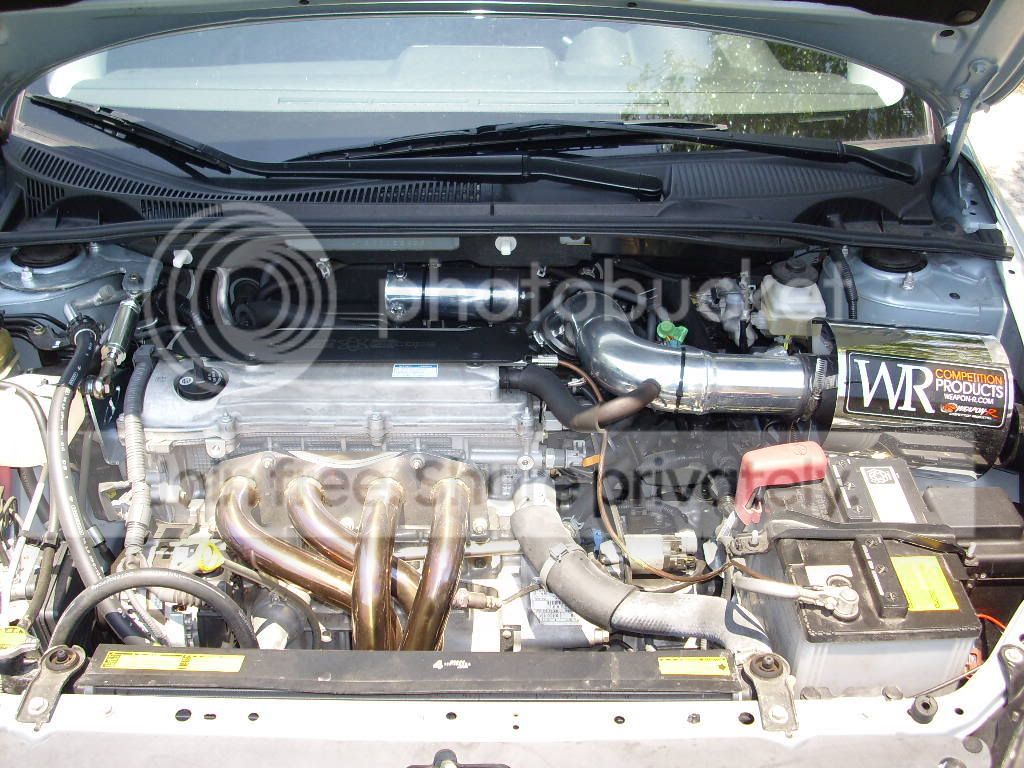

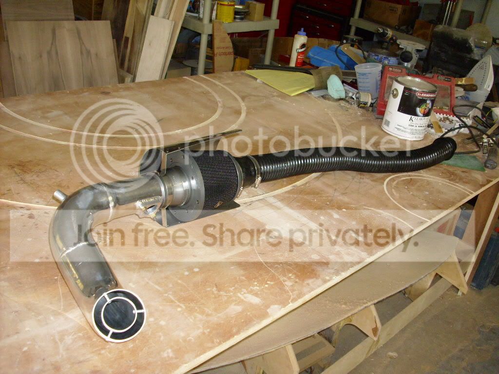

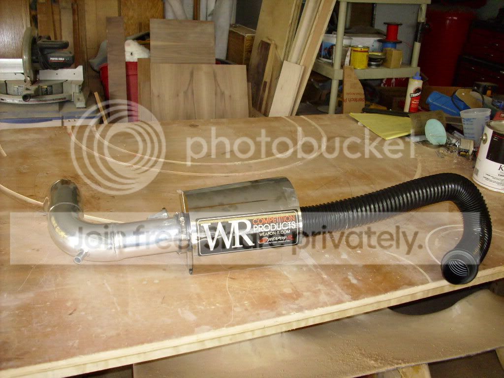

Hey man that looks great! I extended my WR too but i just basically built the "RAM" attachment that WR sells for 50$ but i made mine for 15$...
I like the way yours looks better but i was skeptical about the WR filter fitting in the fender as well(its huge) so mine still sits in the engine bay with the ram air attachment hooked up to the filter's top flange like this...
sorry about the huge pics.
also one TIP get rid of that crappy WR PCV hose...its crap no matter how you look at it.
it collapses when the engine is under load(aka when you not lookin
) just use the hose from the stock box works perfectly...
