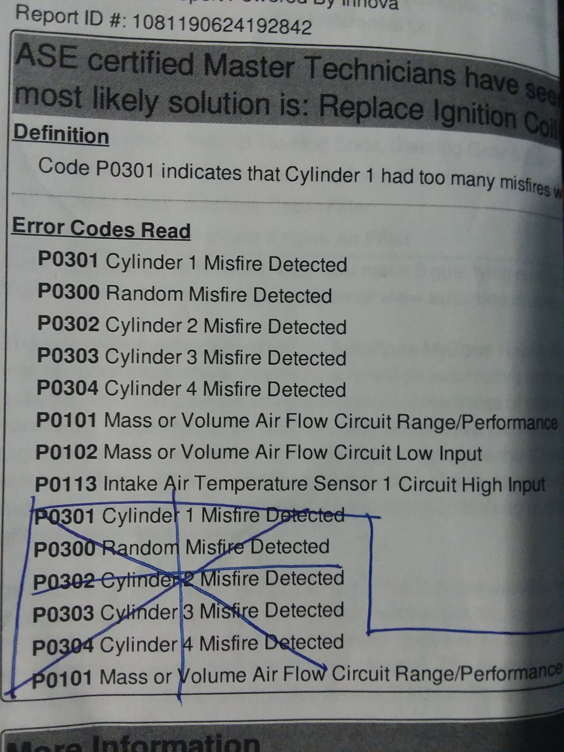

What diagnostic codes are you getting?

Old 07-03-2019, 10:18 AM
TimsScion07's Avatar
Join Date: May 2017
Posts: 8
TimsScion07 is offline

Is the "Intake Air Temperature Sensor 1" same as MAF sensor?

I would I think that it is the same because that's the only sensor I have on my air intake

P0301= Engine Cylinder 1 is Misfiring.
P0302= Engine Cylinder 2 is Misfiring.
P0303= Engine Cylinder 3 is Misfiring.
P0304= Engine Cylinder 4 is Misfiring.
