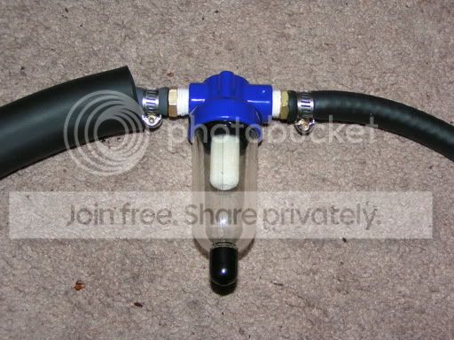

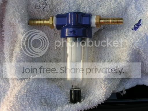

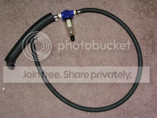

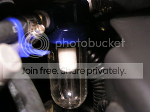

heres some pics of the homemade one I did. Like I said not as much bling as the greddy but its small and easily hidden, cheap- under 20 bucks, and easy to make!!
this actually has a filter in it so it does a good job stopping stuff from getting through, just go to wally world and pick up a mini air compressor filter, some connectors (I think its either 1/4" or 1/2" npt to a 3/8" hose fitting.) And some 9mm hose or if you can't find 9 mil get the 3/8 hose and some good hose clamps to secure the line. I used the stock line for the back half incase I wanna take it out I still have it. Also that way I didn't have to take it off the intake manifold so it eased the installation a tad. I'll get some pics up as soon as I can get some in daylight to show you results, after three days of city driving back and forth to work i've got roughly a half an ounce or so of fluid built up. The filter has turned light brown and still collecting more. Any suggestions comments complaints etc. are welcome.
