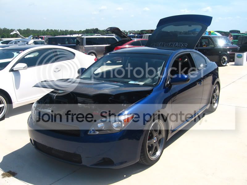

I don't have any pics of my stealth engine bay setup.... but here is what I did...
* Cover all lines in rubber fuel hose. You can find it at any autopart store. Just slice it with a razorblade and use black zipties and/or black electrical tape.
* I'm spraying my wet shot into a throttle body spacer that I tapped. You cannot see anything due to the fuel line covering the braided lines and the location of where the spacer is tapped.
*The solenoids are located under the battery terminal.
*For car shows, I have my bottles like you will see in the picture below. For daily usage, I put two 10lb bottles where the spare tire usually sits.
I don't have any engine bay shots, but you would be able to notice anything except for 4 extra black rubber hoses that aren't normally in the tc engine bay.

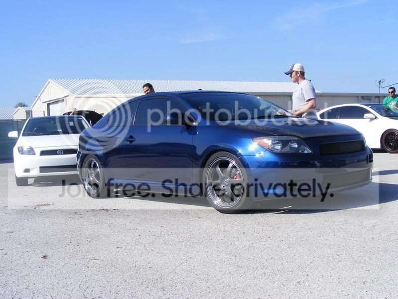

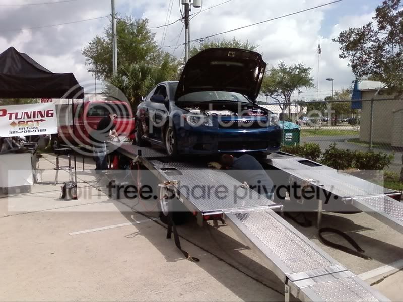

Here's some pics for your viewing pleasure. I'm on a 75 wet shot using a Ny-trex Triple Threat Kit. 14.1 @ 97mph with I/E/H/P. Dyno'd at 232whp 289wtq on an 88F day.
