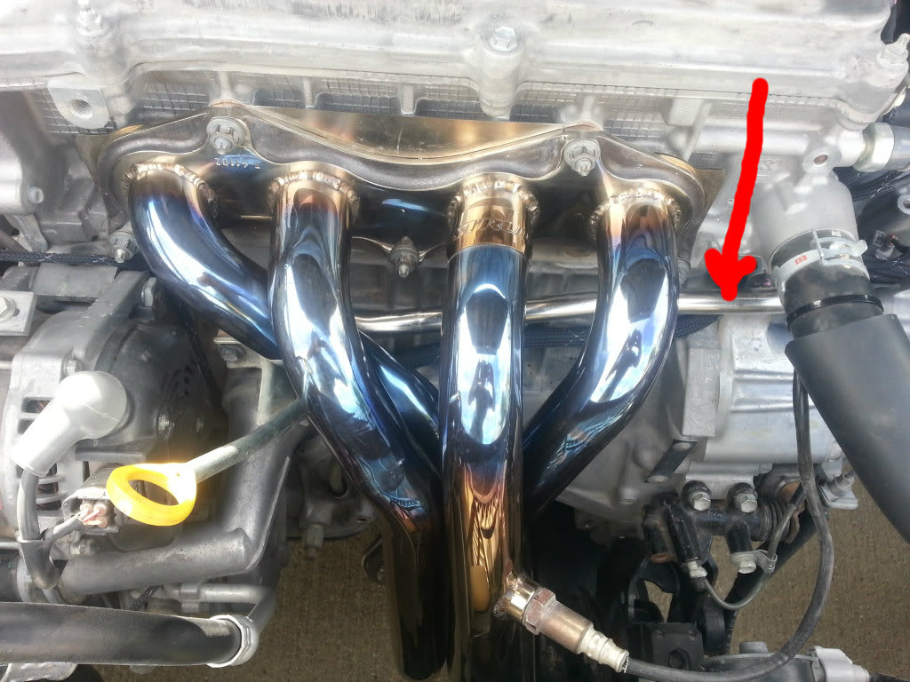

No I was talking about little hose connected to this tubing
Some oily purple liquid came out there. Was kinda hard to tell if its Toyota pink coolant or Royal Purple oil. I think it was coolant though.
Originally Posted by draxcaliber
the header itself should have nothing to do with radiator temp, but your installation process sounds like something went wrong with your cooling system, make sure nothing is leaking, and there is enough coolant and there isn't a kink or something with those hoses.
Yeah now i don't think it was header related problem. I just happened to drive my car a little harder than usual and cooling system failed. I disconnected the battery for 15 min and put coolant overflow reservoir back on,
put in some water in there.Drove the car last night on the highway for about 20 minutes and today to work and back about 50 miles and the temperature seems to stay low. Does this look right to you guys?
