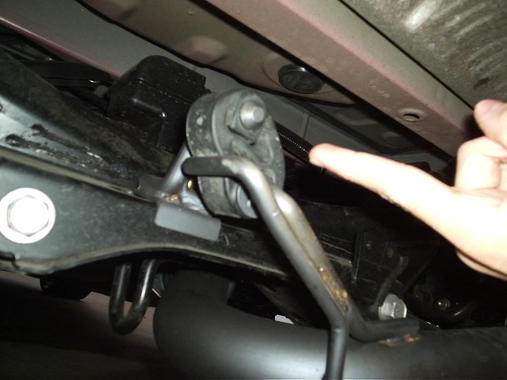

ok im being stupid because i actually have the bracket thing but i dont know where im supposed to mount it? when i finished up hooking it up to the other hangers and bolting it in i was left with the bracket and i couldnt quite tell what to do with it as it was getting dark. as it is the exhaust jiggles a bit much more than im comfortable with but i test drove it and was fine. i would still like to complete the installation though.
Old Nov 11, 2009 | 11:39 PM
BZinn1's Avatar
Posts: 9,538
From: Washington
the bracket mounts to the crossmember between the wheels facing up and the rubber hanger goes on it tothe other mount point on the pipe.....

yeah i got that...but i didnt really find a place on the crossmember to mount it unless i was just looking in all the wrong places.
Old Nov 12, 2009 | 10:37 PM
User 112921's Avatar
Posts: 1,239
The crossmember is just the bar with the big hole, little hole, big hole, etc. It goes on the little hole IIRC.

So for whoever that didn't have the bracket thing that connects to the crossmember.. If you ziptied it or anything, did it burn your bumper? I had it on for an hour or two driving around but didn't feel safe so I took it off
Old Nov 15, 2009 | 05:38 PM
Posts: 1,239
By the way.. here is a picture of where the hanger that sits over the crossmember should go. (For those that were curious)
