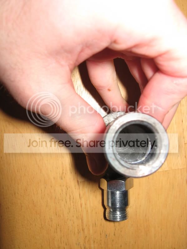

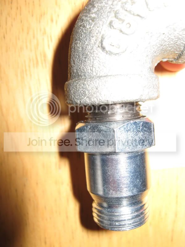

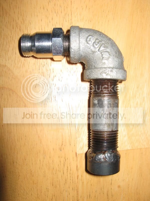

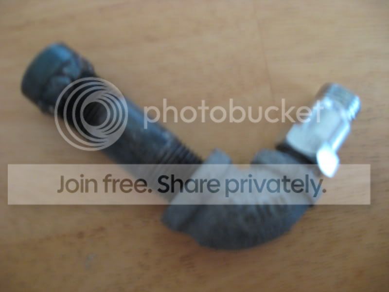

OK well i dont have the right tools or the patients to drill through an antifouler so I made a weapon r style one.
I took an antifouler and went to my local hardware store and bought a 3/8" galvanized steel connecting nipple, a 3/8" to 1/2" 90 degree elbow, and a 1/2" piece of 2" pipe. I screwed everything together, then went to my exhaust shop and had them weld an o2 sensor bung on to the piece of 2in pipe.
and heres the end product.
i'll update after a few days to make sure no CEL comes up but so far so good.

yeah i have a thread locker on it and a silicon seal, but its been about 60 miles and no CEL

Cause I dont own a drill that could cut through the antifouler,
and big bird it keeps u form getting a cel when u delete the cat by replacing ur header
