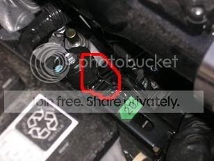

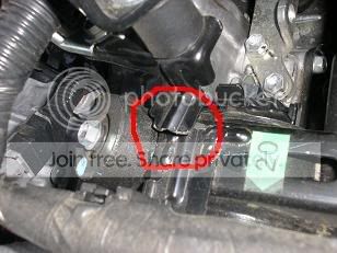

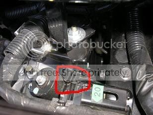

Seems like all the movement in my engine bay has finally cause some damage. Looks like the thing just cracked off and i don't know what i need to do. Should i get it wielded back on? or check with toyota and see if i can replace whatever part this is but then it was an after market intake.
Maybe this will help.

Almost all aftermarket intakes break that mount. It's unfortunately "normal." I doubt the dealership would just replace it, but it can't be an expensive part.

This is a common problem with almost all aftermarket intakes. Luckily Dr_Isotope and I came up with a solution for it.
Check out this thread:
https://www.scionlife.com/forums/viewtopic.php?t=159654
And then purchase one from here:
http://doctorisotope.com/index.php?o...d=25&Itemid=29
