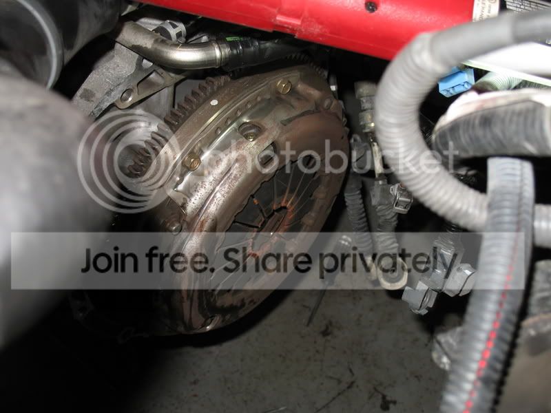

after the subframe was off.. they next step was getting the tranny out... from my vantage with the camera above the car watching both the guys attack the project from underneath the car it seemed failry simple to get off the exsisting tranny... once there was a spot to pull them apart from.. took a bit to get that area wiggled out... didn't look like fun while also trying to support the wieght of the damn thing.
View of the clutch when the original tranny was off...
Once the clutch and fly wheel was removed i made a dinner run for the hard workers :: and came back to find that the new clutch and a resurfaced flywheel were back on the the car..

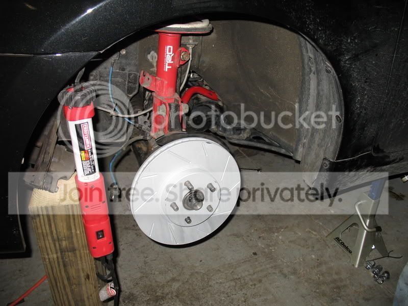

Rotors (old)
Rotors (new)
After that... got the shocks/springs back in with new rotors
