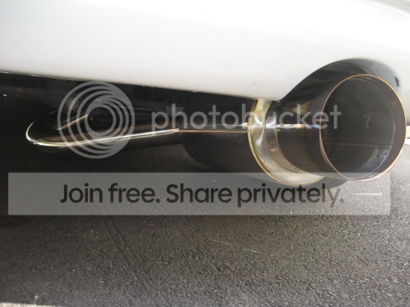

i ordered a Tsudo catback with the burnt tip from speed element about 2 weeks ago and it finally came in yesterday. I already had my tools out before Fedex even got here. Actually... The car was jacked up before fedex got here lol. i opened the box to find a nice sexy!!! RAWR... Titanium COUGH COUGH burnt tip... Catback. I paid about $263.00 including shipping. I got the stock exhaust off pretty easily since i have air tools , But those damn exhaust hangers are a pain the butt. Everything mounted up right but there was two problems that are common with MOST tsudo catbacks.
1) The resonator hit the exhaust heat shield bolt. So what i did was take the heat shield off and cut the bolt off. who needs that damn heat shield anyway.
2) The muffler hit the bumper like usual. So i went to autozone and bought a longer exhaust hanger, Those rubber ones. Cost me about $4.00. I tried the socket trick but that didnt bring it down low enough. I also noticed after putting the new hanger on that the muffler didnt come out straight with the bumper indent. so i took some muffler strap and pulled the metal hanger which ever way it needed to.
OVERALL i give the install a 3/5
Quality- 4/5
Value 5/5
Sound 4/5 Its kinda loud.
VIDEO!!!
One thing that does not come with the burnt tip tsudo that i kinda wish did is a silencer. Im not sure if tsudo does that with all their exhaust, but i didnt get one
Instead i went on ebay and bought one for about $9.00 shipped. I never liked the look of that tornado looking silencer from tsudo anyway.

Nice pics, I never realized the pipe was so low to the ground...hope it doesn't hit anything!
Old Oct 23, 2008 | 10:03 PM
quadboy47's Avatar
Posts: 304
yea it is kinda low... im gonna go to a muffler shop and see what they can do

dont get it too close to ur bumper it will burn... it looks good to me u should see my hks its pretty low like that

i got the same exhaust n it hangs just as low n it never really scraped

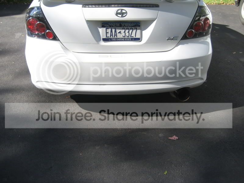

Bumpers got dents yo!
Old Oct 24, 2008 | 02:05 AM
quadboy47's Avatar
Posts: 304
haha i backed into my g/f's 2007 civic lmao in my own driveway

yeah the only thing keeping me from getting that exhaust is how low the exhaust sit to the ground. my friend had one and he was shooting sparks all over the place...

wow, the adjustments you made made it look like it fit perfectly!
nice job
