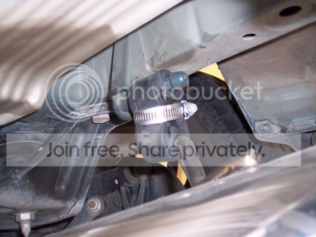

well this what i did so it wont burn my bumber

haha reign, yea ur link is of Mzle's tc, same one the Mizle said ain raspy. i liek it. so tht fix legionscion did, all i need is a clamp or wat. haven;t installed an exhaust before, so if u can tell me wat u actually did.

lol its really simple to do what he did......just get one of those clamps from any local auto store and just tighten it around the last hanger than holds the canister up. it drops it a bit and prevents from melting.

would that hose clamp evenutally cut the rubber? so a mistake would happen. i mean you might end up with another kid.

but it would eventually dry and you would have to replace it right? im being serious about asking this question.

i doubt it would. thats some pretty thick a$$ rubber

You will be fine with the clamp on the hanger, it takes years and years for that rubber to dry rot.
