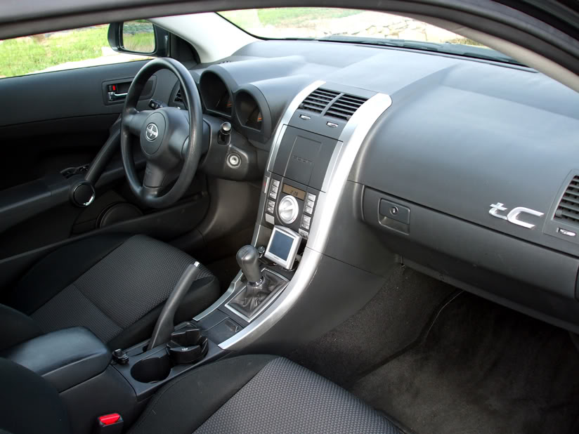

Originally Posted by bigBOAT
good luck with the install waiting on pics man!
I have an old pic, but it has the Megan SS in with the stock ****... I currently have an aluminum **** on it and it feels much more solid in conjunction with the solid bushings...
The only downside to the aluminum shift **** is that it'll nearly burn your hand during the summer months if you parked your car outside in the sun with the sunshade open...
