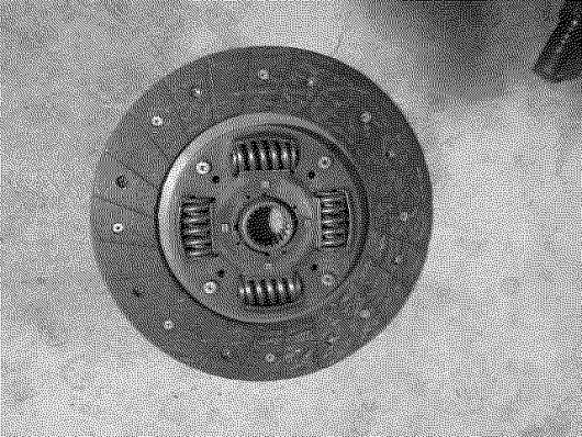

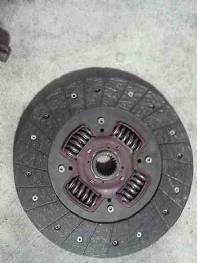

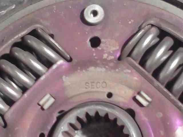

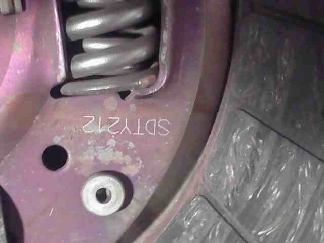

I'm in a Paypal dispute and I just need everyone possible to tell me what kind of clutch this is and why you think that you do please and thanks it's supposed to be a stage 2 CLUTCHMASTERS for a scion tc Mods please verify-imageuploadedbytapatalk1352835582.673478.jpgMods please verify-imageuploadedbytapatalk1352835608.953359.jpgMods please verify-imageuploadedbytapatalk1352835623.159944.jpgMods please verify-imageuploadedbytapatalk1352835637.756382.jpgMods please verify-imageuploadedbytapatalk1352835650.946191.jpg

Default Seco website
http://secoclutch.com/english/c_prod...product_02.php

Mods please verify-imageuploadedbytapatalk1352837873.216873.jpgMods please verify-imageuploadedbytapatalk1352837882.018497.jpg
Had to repost pics upright also if you look at the black and white pics you will notice that this clutch is also spray painted yellow

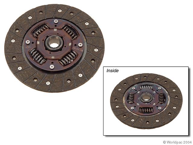

My thoughts are you got scammed here is that SAME!!! clutch disk here's the link
http://www.autopartsway.com/PartList.../pagenum1/tabS
Here's the pic from online
Here's your clutch

So to sum it up some one ripped you plus by looking at the pressure plate that was clearly repainted Wow cant believe someone would pull these!!!
