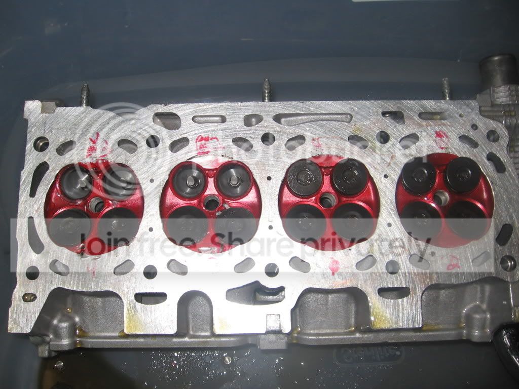

Big bird, you can keep your riced out box and negative attitude in the your own topics. And Arnold, what's with this karbon crap? Because I used his pictures for examples I'm no this user? and tcleazy? You guys that bored with scionlife you need to start a fight where ever you go? If you have a problem with me PM me.
Now for what happened. This is all the mods I have done so far.
TRD supercharger, stock BOV and Pulley
Gude Performance Cams. 420/410 lift (similar to BC n/a s3 cams)
Gude Performance TB. Ported with new butterfly valve
Gude Performance duel wound springs and retainers
Gude Performance port and polished head
Dezod Valves
NST pulleys (s/c pulley stock)
OBX header and S-pipe
Megen mid pipe
TRD axle back
OBX TB spacer
Custom CIA with AEM filter.
Stock pistons and bottom end

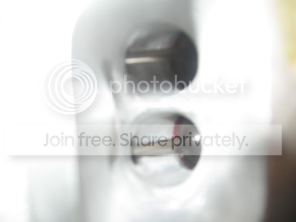

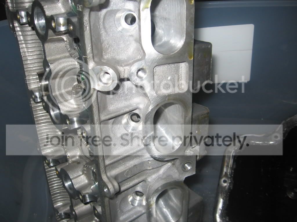

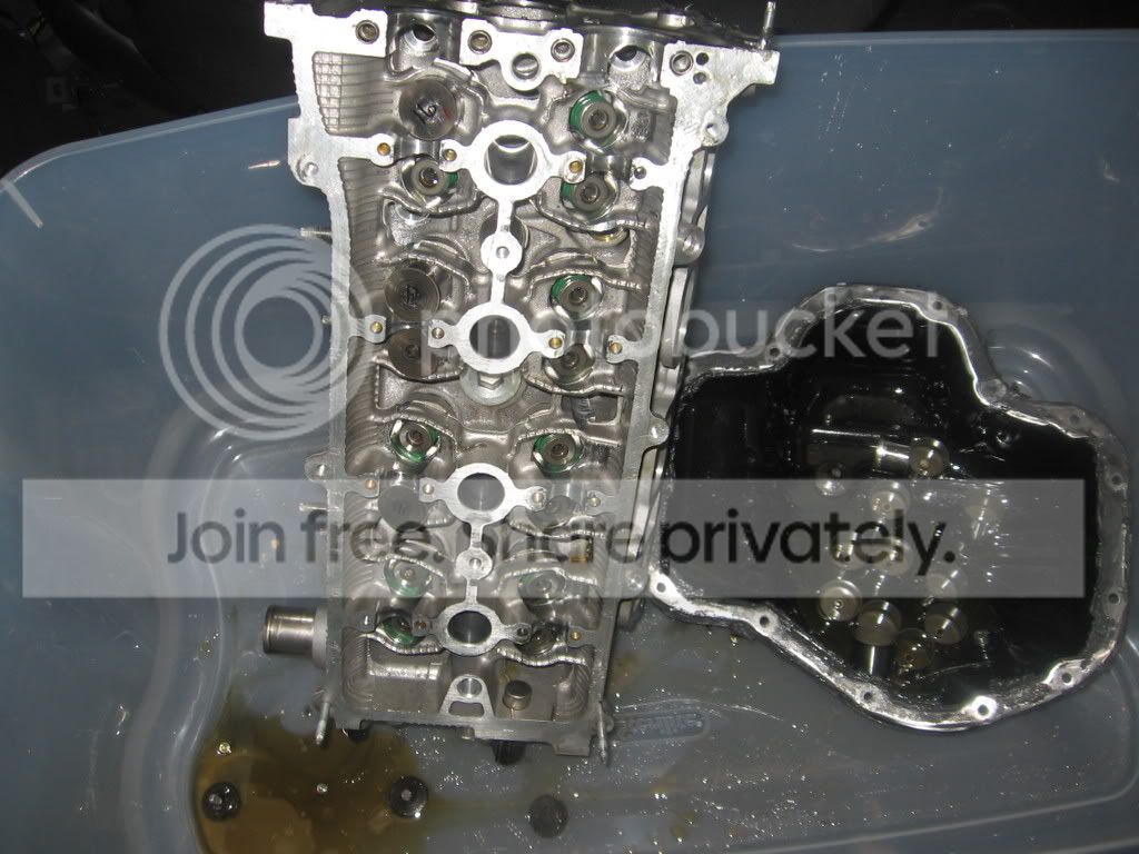

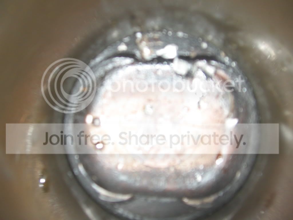

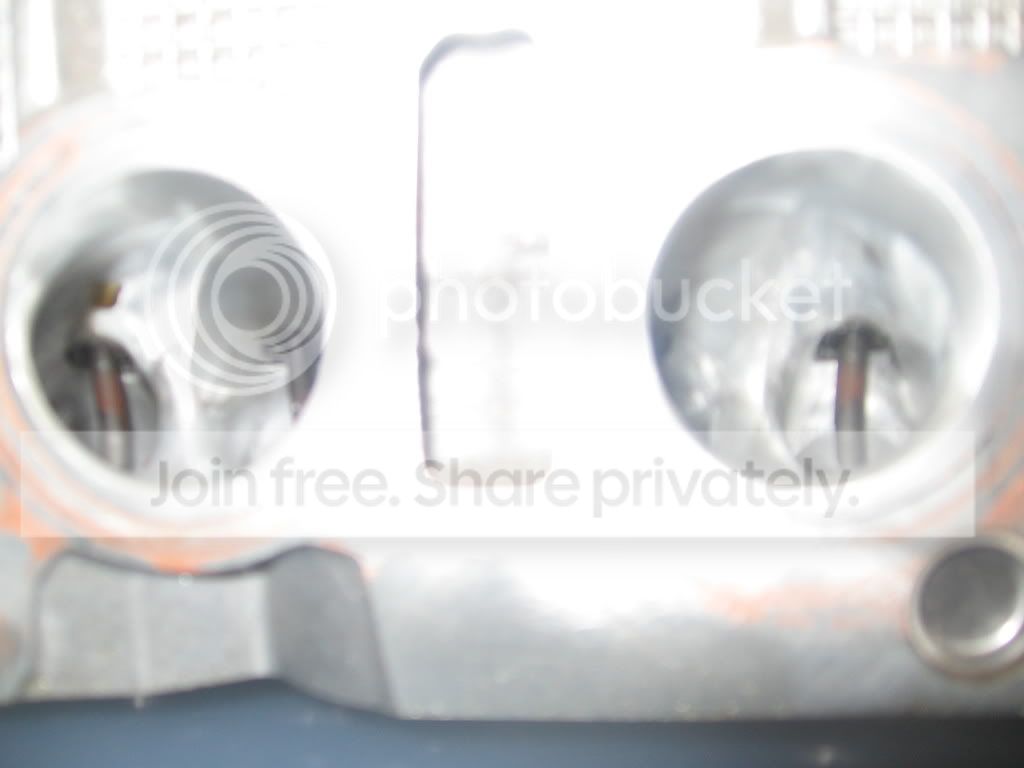

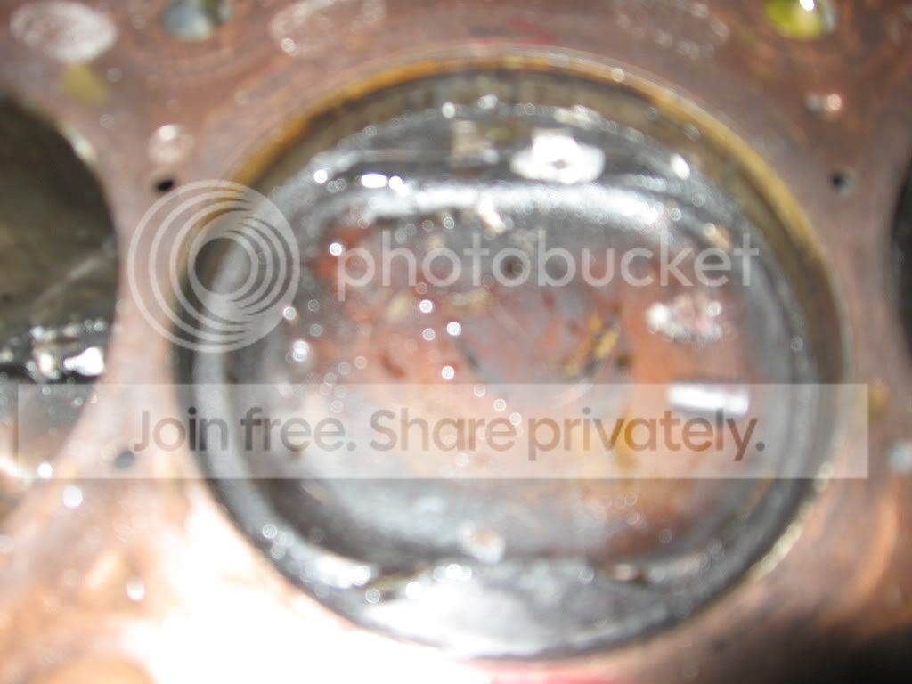

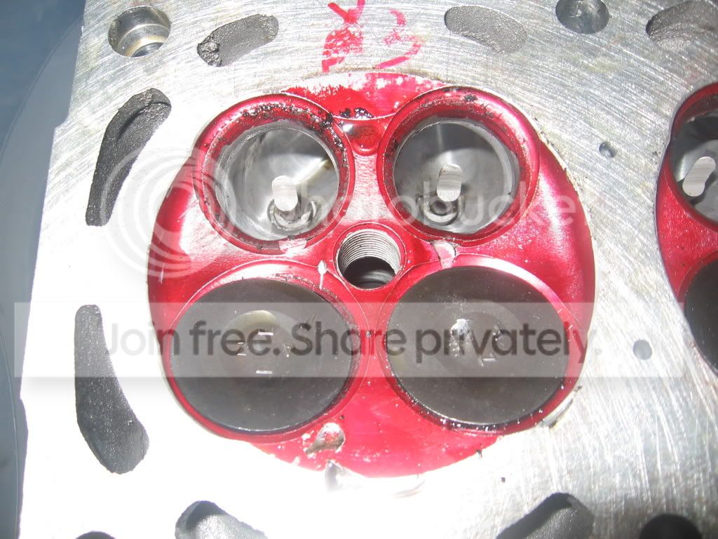

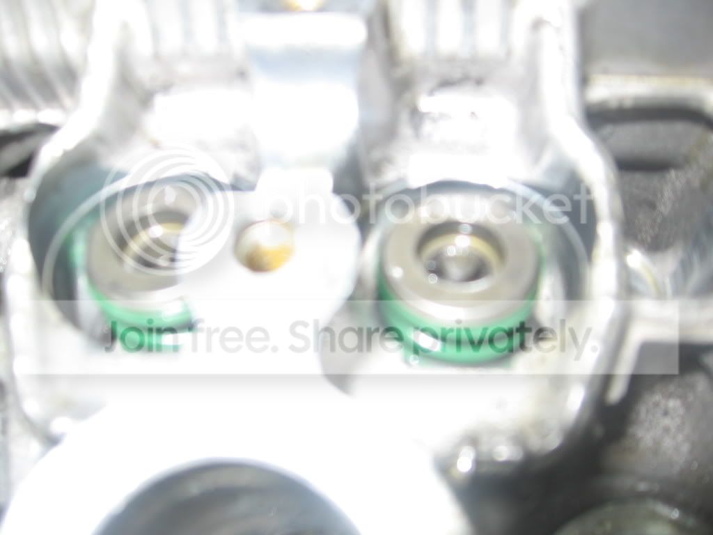

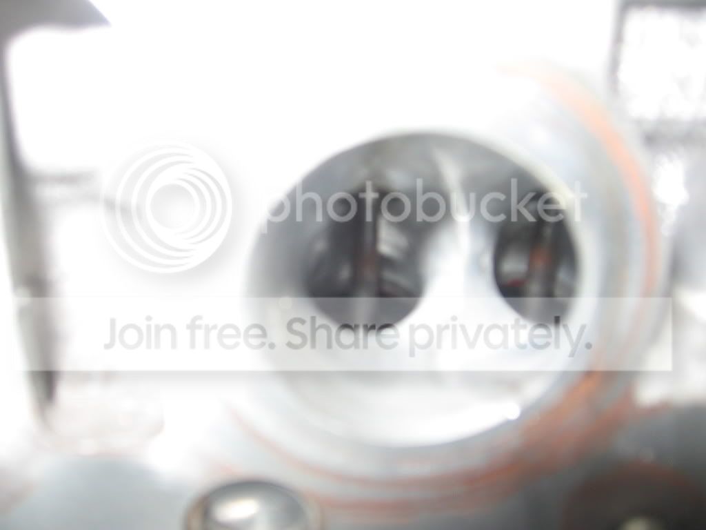

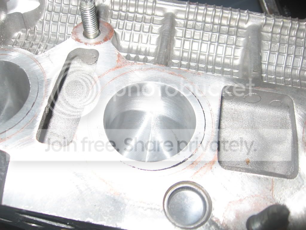

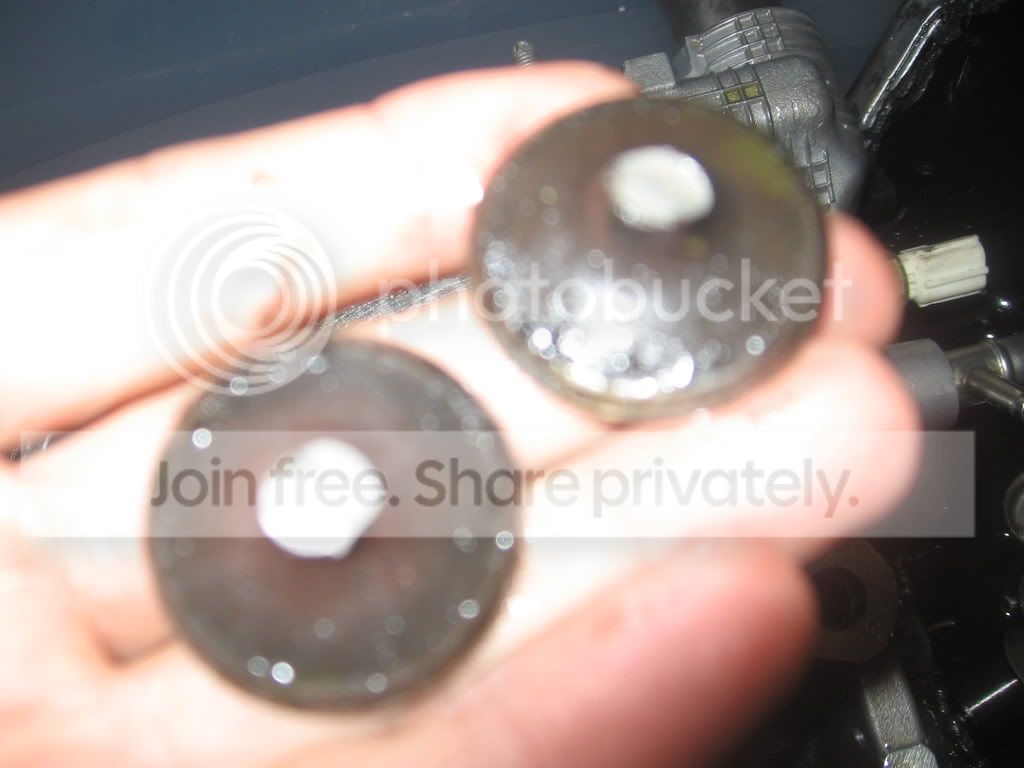

The block is still good. I think I'm going to go with pistons and rods, I'm s/c'd and want to put in the 12 psi pulley so i think a lower compression will be better. Any ideas? The head is still good, needs to be repaired. and New valves put in. I might sell the supercharger for a TurboToyota's Kit. IDW yet. Here's the motor now....
It's hard to see the damage to the pistons from the pictures, the oil is making for a bad flash.

you need a macro setting on your camera

any time iv built an engine or installed a crate engine i always rotated the crank by hand first to check if pistons will hit the valves. just a safety measure just in case i had a brain fart and set the timing off, not to mention when you get a crate motor you don't know whoever assembled it did a good job or not. its a five second process that can save you hundreds of dollars if not a g or two. i dont know how the head will be able to be salvaged, it will be tough to get those bent valve stems out of ther without creating more damage, valve guides maybe bent which will be hard to remove aswell, i wonder how the geometry of the valve guides will be changed. I havnt had this happen to me so im only speculating. looked like a great porting job though if thats any consolation. good luck on the next engine
