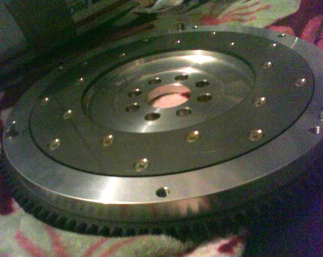

Pics of the flywheel, i think it was a great buy for alil over 100$ what do u guys think??

here are the darker pictures up top ligthneded up sorry
