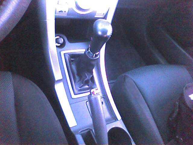

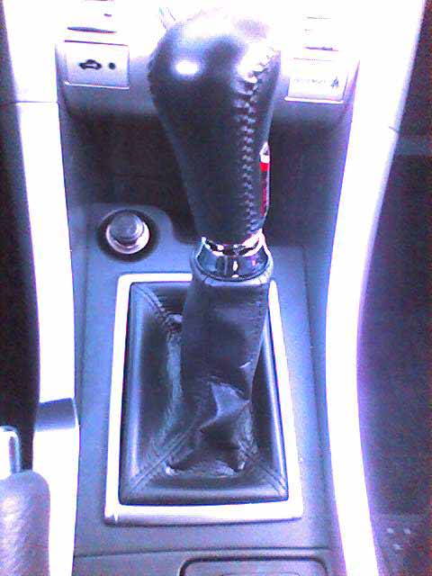

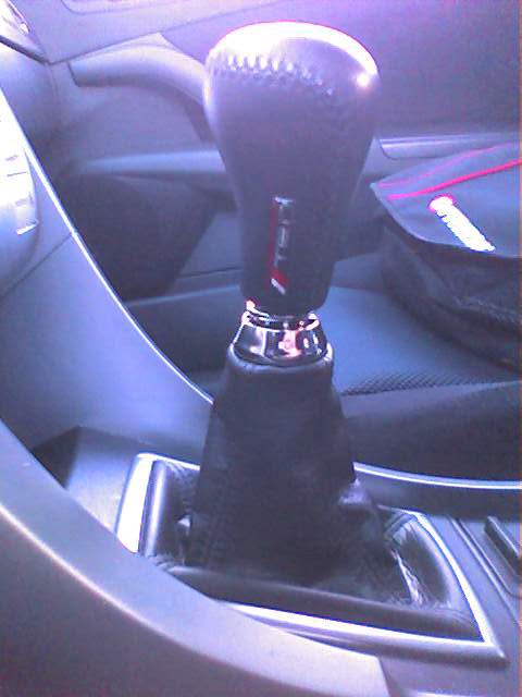

Hey, so I got mine installed about two weeks ago, but I'm not completely convinced it's right... It's been set as low as it'll go ('cause I guess the bottom was kinda scraping against stuff), and it doesn't actually feel any/much shorter than the stock one... and I didn't really notice the throws being any shorter either... I'm gonna have to ask people to measure stuff...
(in height, when it's shifted into third, say, I can reach my index finger forward and I'm just about at the middle of that temperature dial)
...On the plus side, the shifts are definitely more solid--as in, you can totally tell when you get in a gear, and there's no wiggle after you get into it.
There's a bend in the rod, that I set angled towards me, which is why it seems to bend a little bit in the pics (especially the one from the back):
(oh, and my camera phone just doesn't have the quality that I'd like. :shrug:
From the back:
From the side:
From the driver's view:
From the back:
From the side:

thanks for the pics shadowhawk, I checked and my index is about the middle of the dial also,
I also used my tape measure set it flush against the plastic part of the center console the vertical part and the end of the tape on the back side of the shift **** in third it was at 8 3/4",in neutral 10 1/2",and in forth 12 1/4" I can get a pic if you need a visual.

Hey STAT,
Thanks for measuring your shift locations. Think you can measure the height, too? from say, the plastic rim around the boot at the base of the shift lever to the top? maybe in first or something... so from the forward left corner of that rim.
A pic of one of your previous measurements would be nice, 'cause then I can be sure of putting the end of the tape measure in the same place you had yours.
One interesting thing is, the shifter does seem to take my hand much closer to the console... as when I'm shifted forward into third and fifth (which is where I notice it most often...guess i don't spend much time in first), I literally can just uncurl my index finger and touch the temperature dial.
That *seems* like it is closer than it was with the stock one....but I can't remember...
...anyway...if ya can put a pic up of your tape actually measuring one of those positions, I can replicate with the perrin and report back.
