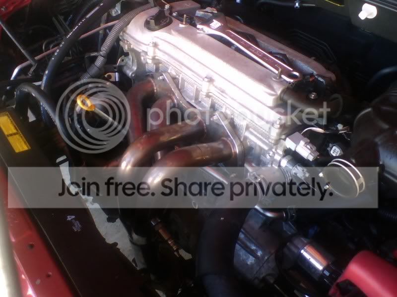

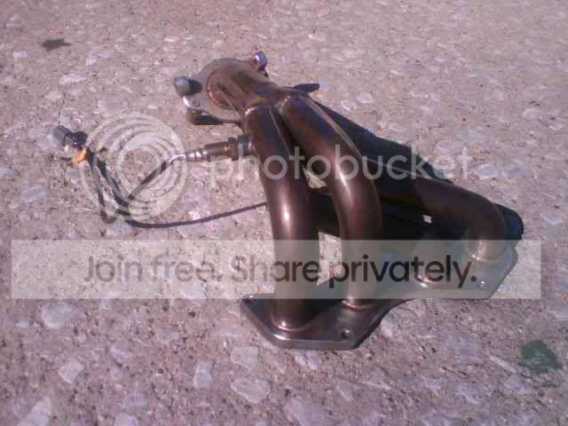

Ok... Thanks to my friend Tim and his friend I didn't have to pay anything. I got lucky and am thankful!. I got Megan Headers. Man I did notice a good increase in everything, I don't even have a bad rasp problem and I'm not even muffling anything. These are great! Sounds so much more powerful too might Id add.
My only problem is that the stainless steel finish has its share of oxidation or what ever you want to call it.
Would I be risking the finish by really giving it a good rub down with a fine steel wool pad and then using metal polish on it?
Suggestions?

Wet sand with soapy water and 2000grit sand paper. And wear gloves and wipe with acetone or rubbing alcohol after installation to remove oil left from fingers etc. And don't let anyone touch the thing once its installed. I have pics from when I cleaned up my header I bought used but I don't know where they are are the moment.
