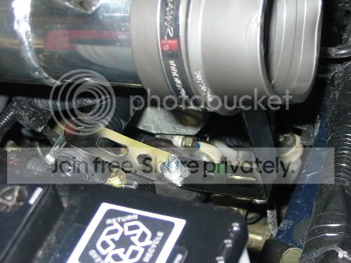

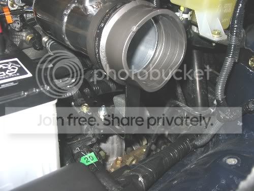

Hey guys, just got my intake today.. everything installed fine but I can't figure out where to put the mounting grommet and the bracket.
Can anyone help me out? Pics would be greatttttttt

i mounted mine to the front of the intake and to the second hole where the stock box was located, you have to use one of the clamps that came in the kit. on the bracket there are holes on one side and a lip on the other, put the bracket lip around the clamp and tighten it to the front of the intake. then bend the bracket to fit and tighten it down. hope this helps a little

Hope these help. You have to bend the bracket some to get it to fit.

Cool, thank you guys very much. Those pics are perfect. Can't wait to put mine on tomorrow, I'll take some pics of the install. Thanks again!

I just did my WR SW intake install yesterday and everything went great. The whole install only took a hour at most, I was taking my time also. I ended up mounting my bracket in a different spot with the supplied hardware. I took a few pics.
I made a 90 degree bend in the bracket 3 inchs down from the top and the hooked it under the strap connecting the filter
I screwed rubber mounting bolt thing (tech term) into the bolt hole closest to the motor from one of the factory airbox bolts. Then I connected the backet to that using the lock nut and washer.
This makes for a really nice install. I took a bunch of Pic's so I'll soon try to make up a quick how to. Hopefully this helps people with this install.
