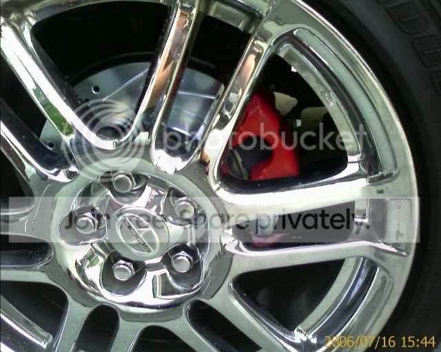

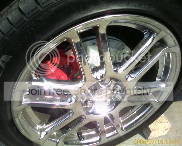

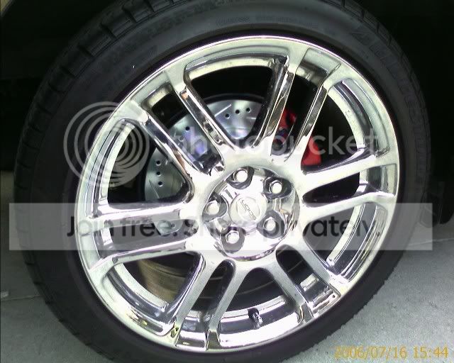

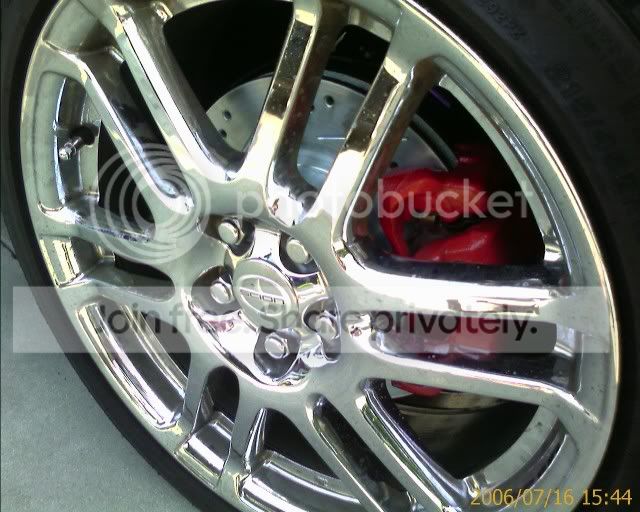

AHH!! figured it out.. I managed to take off the rotors and install the new ones.. saved me almost 300 bucks labor by doing it myself.. 2 weeks ago I painted my calipers red and so now the rotors complete it..
I think it looks good so far.. now to install the strut/sway bars..
