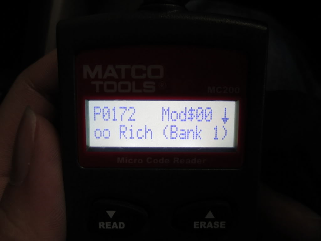

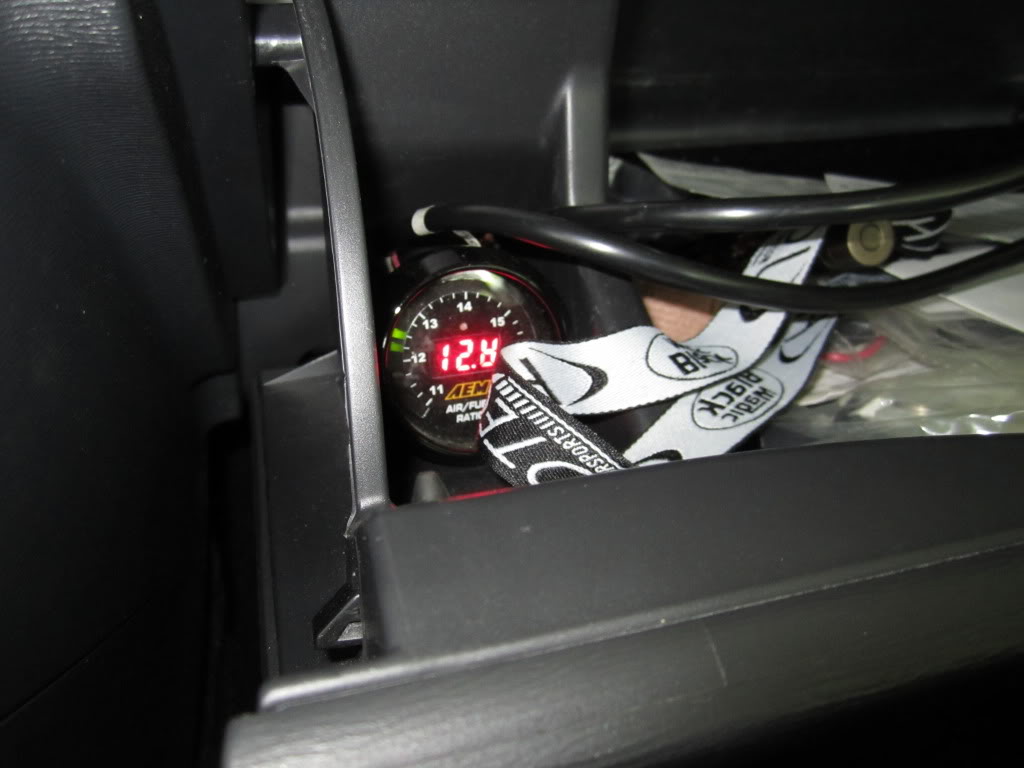

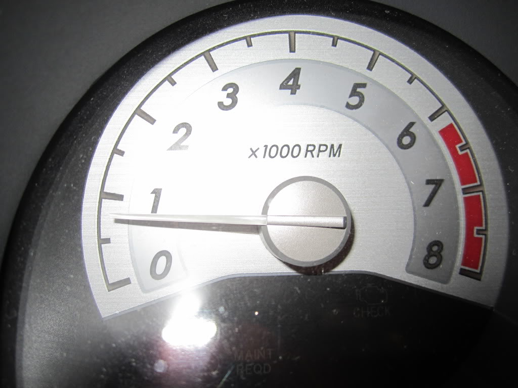

This tC idled low at about 450-550 and when taking off or just cruising at 30 mph it would stumble a litle sometimes. Air/Fuel ratios would dip into 13s and sometimes touch 12s at idle and was more variable than normal setting a check engine light code P0172 system too rich (Bank 1).

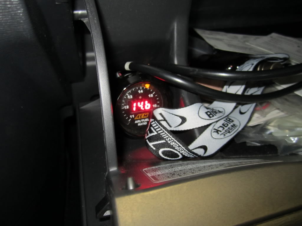

-Start the car; you may notice that it will take longer to start. Lightly press the throttle to clean out any remaining throttle plate cleaner and contaminants. Allow car to idle for a few mintues. Idle may climb and stay a little higher than normal for several minutes even after engine has reached normal operating temperature.
-Drive around normally for a few minutes and return to idle. Everything should return to normal operating parameters.
-Clear check engine light using appropriate OBD-II scan tool
