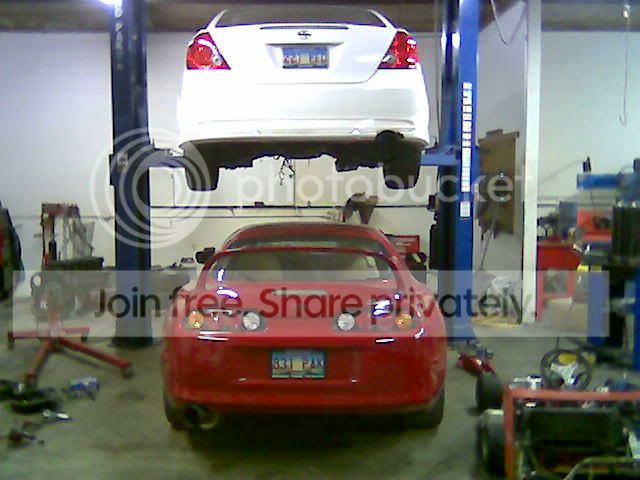

BlkSandPrlTurbotC's Avatar
Posts: 2,834
From: Always In Front Of You
Default Re: Want to see the guts???
Originally Posted by TurboCustomz
Meaning Of Picture:
The Scion tC will always be ahead of the Toyota Supra
Meaning Of Picture:
you mean on top or always a level above? LOL. I wish. Or maybe the tC is a step closer to heaven meaning it will die before the supra. I never even thought about the interpretation of the picture till you brough it up. Hmm. Wow I just realized this post is 10 days late.
