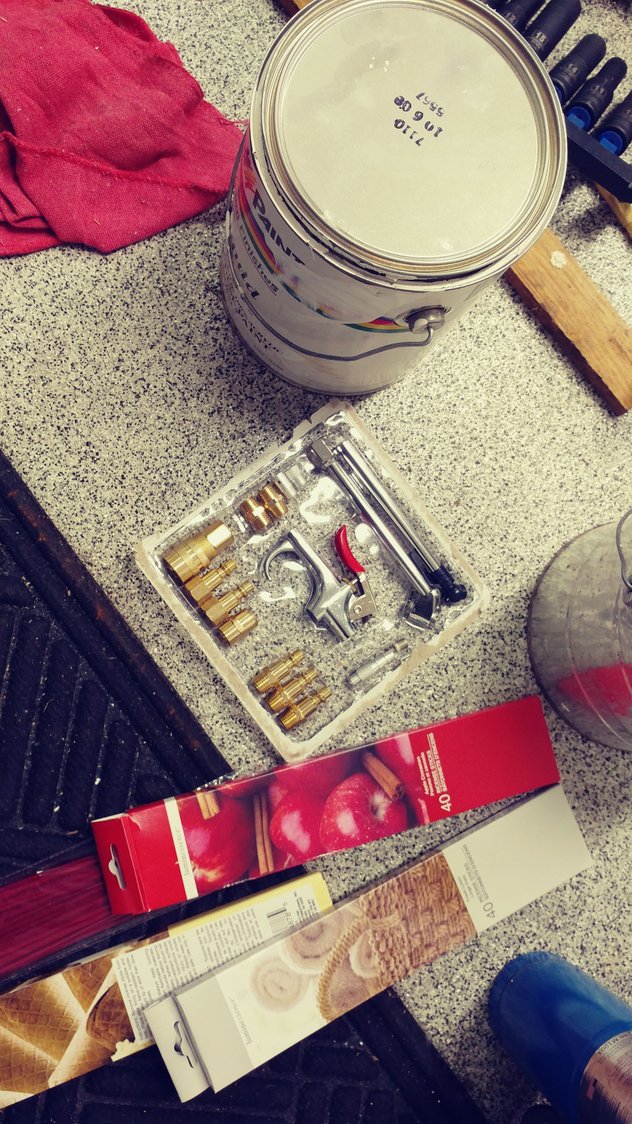

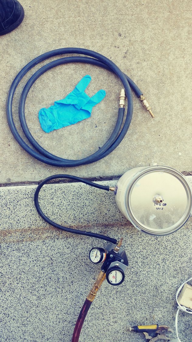

Finally had a 57 degree day to check for leaks. Spent about $15 and used some random junk in the garage to build a smoke can to fill the intake. Took about an hour to build it and find the leak.
Youtube vid of the smoke leak
https://www.youtube.com/watch?v=HzWc...ature=youtu.be

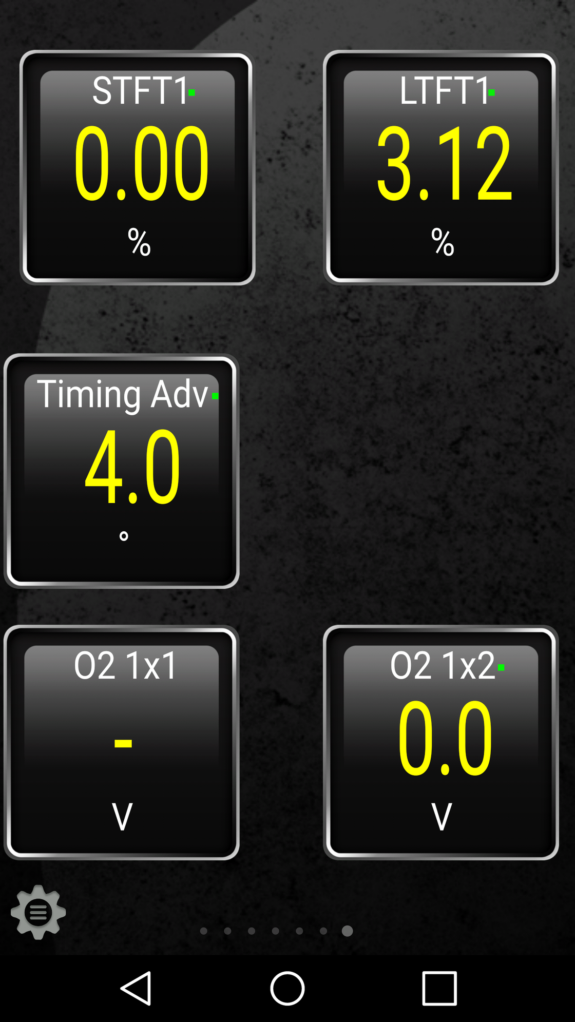

why does o2 1x1 show a "-" in the reading? I set this up also (I got a Veepak adapter) and show the same thing. I do keep seeing a warning saying that something about rich to lean current max threashold reaching 133 (where 12 is the max.

Probably was setup for my other cars and was only monitoring the fuel trims for the Scion. I am working on 3 different vehicles right now and keep going back and forth checking them.
