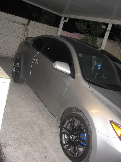

i bought the tC crash got it for 4k 2k in repairs. bought in 2007 its a 2006
from this
to this
