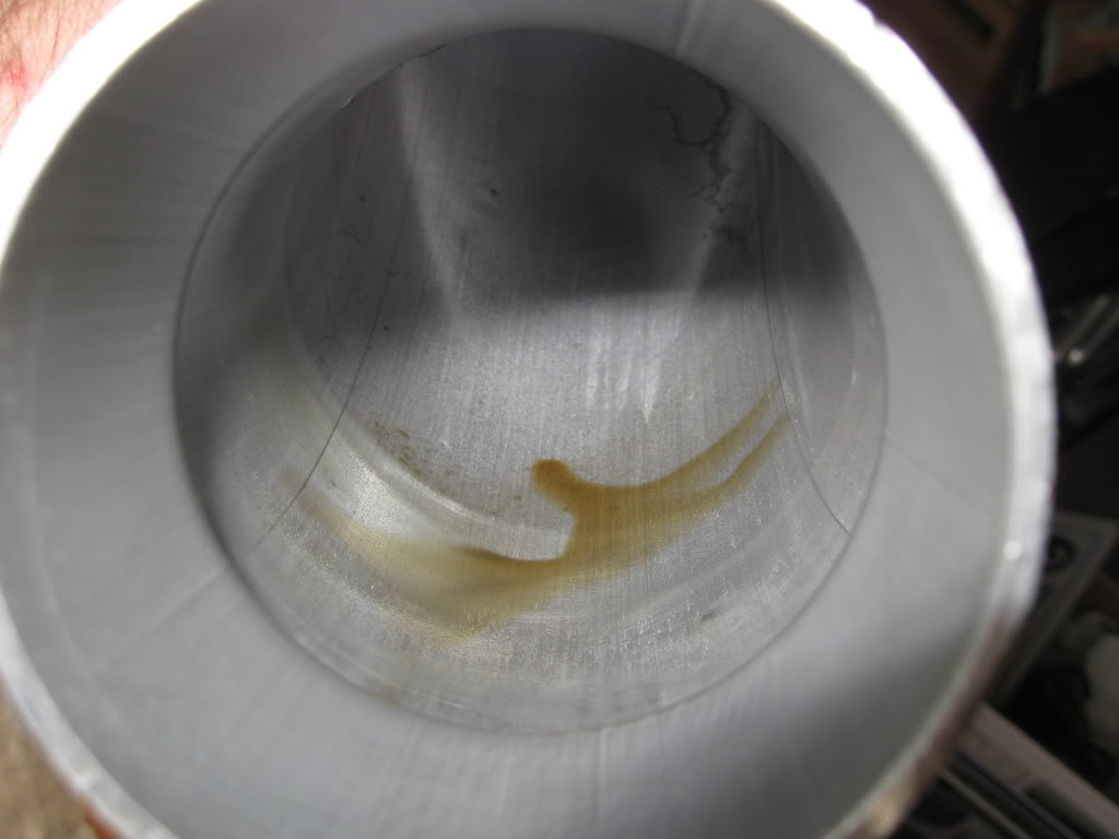

i tried em....fittings are soo close that oil vapor just goes right through em.
here is proof
(inside the intake pipe the catch can was routed to)
the catch can (i painted it black)

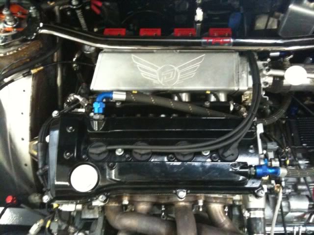

We drill & tap our valve covers to 3/8NPT and use a -10AN line to the catch can. If your interested I have several new valve cover's that are already done...call me.
Rob C.
WORLD-Racing.com
310.533.8900
