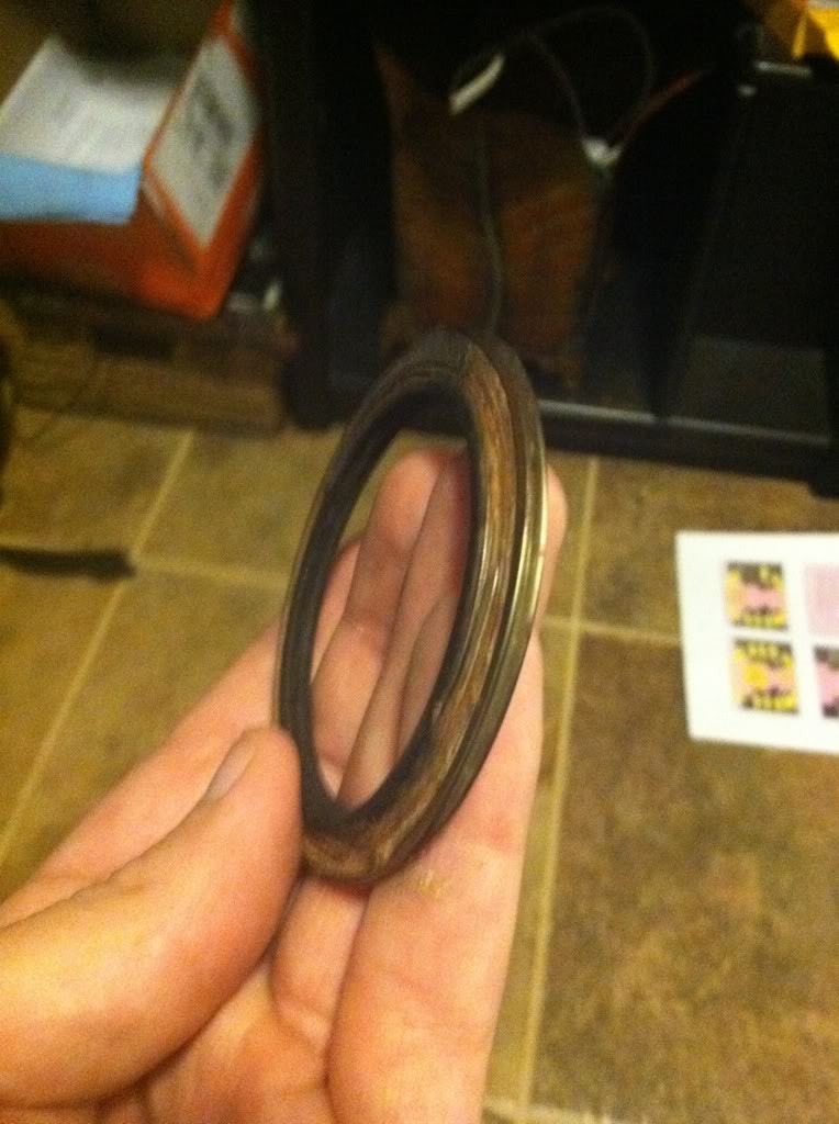

Where is this copper gasket from? I forgot where it came from when me and my neighbor pulled it out

post another angle of it

damn im trying to think where that gasket is from. I want to guess its an exhaust gasket because of the black inside and it looks to be about 2 1/4" diameter. Not sure though.

It is definitely an exhaust gasket. heers:
Old Feb 28, 2012 | 11:20 PM
crush02342002's Avatar
Posts: 11,271
yep located on the midpipe if memory serves (been quit a long while since iv seen a stock exhaust

thanks guys i had figured it out!

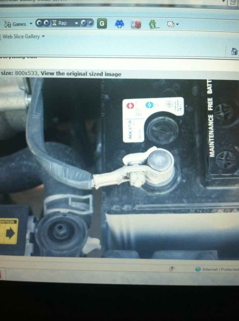

Ok theres only one last thing from me being able to crank it over, i had the battery holder on, my battery connected went into the car to see if it showed power but it didnt. I looked in to the engine bay and seen the other end of the black terminal of the battery dangling my question is where does the other end bolt to?
Heres a pic for reference:
The other end of that ^^
Old Mar 7, 2012 | 11:21 PM
thendawg's Avatar
Posts: 2,720
On the other end there should be two terminals, one bolts to the chassis under the battery tray (chassis ground), the other bolts to the trans (engine ground)

Ok i found the one under the tray but which hole exactly does the other terminal bolt up to on the trans??
Old Mar 8, 2012 | 01:05 AM
sebbyxtc's Avatar
iTrader: (7)
Joined: Mar 2010
Posts: 2,022
From: Bakersfield, CA
I bolted the other end to the hole above the starter on the tranny. Still no power at all to the car. Battery is fully charged. Maybe i Bolted it to the wrong hole. Does the ECU need to be plugged in to get power? Because im trying to do the break in method that trd07tc said to disconnect the ecu and plugs. Please im trying to finish my car
Old Mar 8, 2012 | 10:10 AM
trd07tc's Avatar
iTrader: (-1)
Joined: Aug 2009
Posts: 1,940
From: Milton
it doesnt matter what hole you use as long as its unpainted, clean metal.
