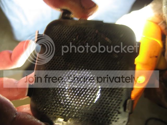

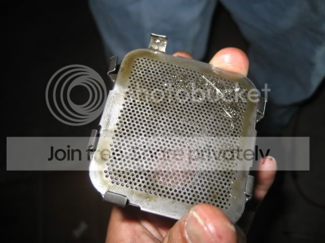

Well guys, I think I'm going to have to say it but my turbo adventure will be ending. I drain the oil and pulled the pan. My oil was COOKED and looked like hell had hit it. There was alot of sludge. We pulled out the strainer to see it covered in sludge, a little pan sealent, and a few shards of metal. Not too too concerning. As I was trying to clean up my oil pan i decided to stick my finger inside the sludge and feel it. I noticed that it felt like sand.... come to find it is dust particles of metal. I'm so so so so screwed. This may be the end of my tC days... sorry to say guys.

Thats blow motor oil :'( Ive seen it too many times now It makes me sad Its build time now though - lemme know and ill help you
