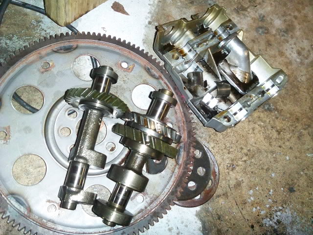

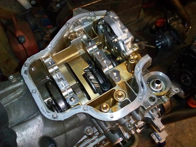

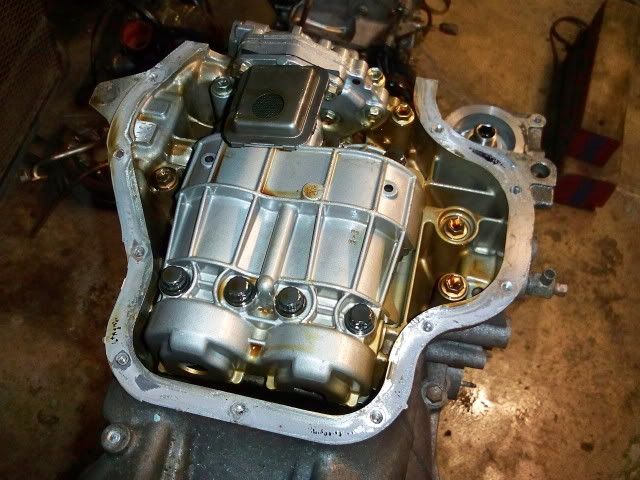

Does anyone know the type of socket and size to use when removing the balance shafts?
Old Nov 14, 2009 | 06:41 PM
gingles's Avatar
Posts: 1,881
From: Denver, Colorado
is it not just a regular 12mm 6 point?
Old Nov 14, 2009 | 06:47 PM
crush02342002's Avatar
Posts: 11,271
12mm 12point...i just checked.
Old Nov 14, 2009 | 06:57 PM
johnhawkins's Avatar
Joined: Oct 2008
Posts: 1,100
From: Buffalo, NY
thanks guys!
Old Nov 15, 2009 | 03:33 AM
gompka's Avatar
iTrader: (5)
Posts: 1,712
From: Chicago
yea 12pt 12mm and don't forget to plug that oil feed hole.
