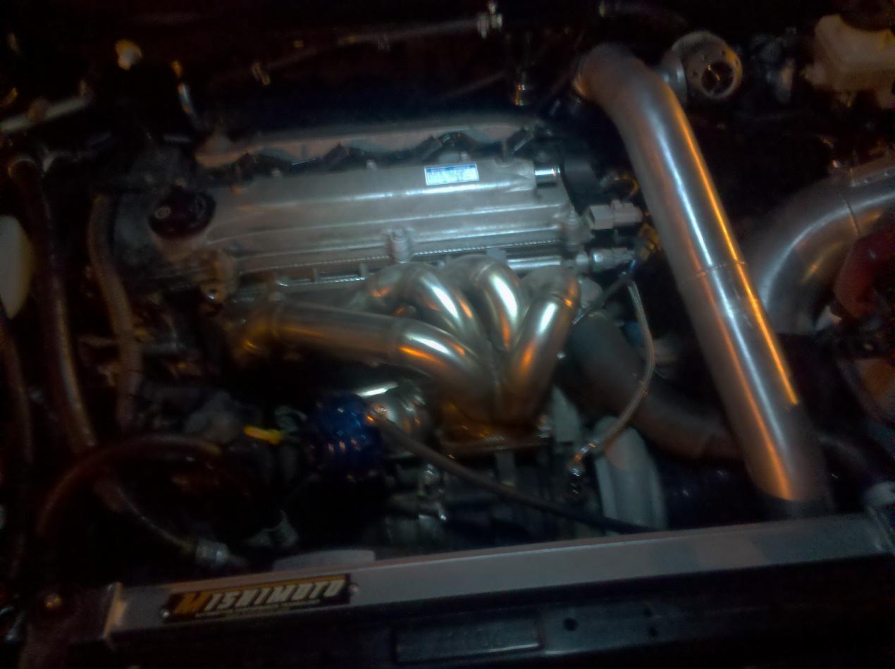

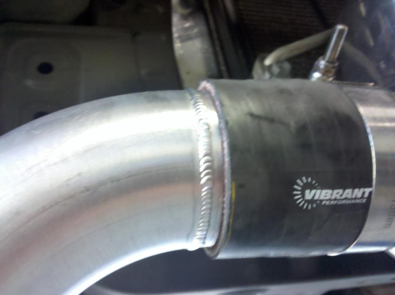

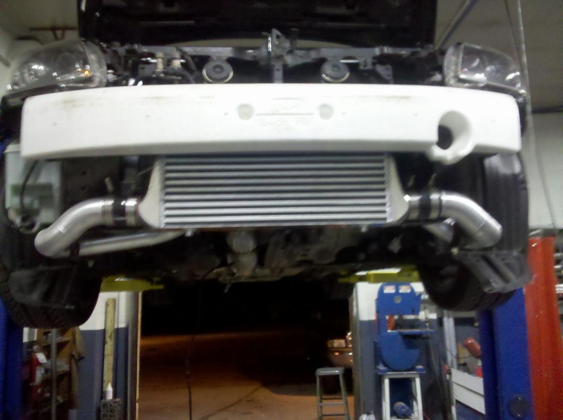

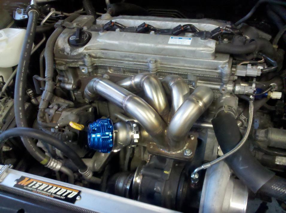

Hi SL as some of you know i have been collecting parts for my build and its finally complete. A lot of my setup was custom built so i definitely went over my initial budget but overall im pretty happy. Setup was done by M20 motorsports by my boy Luis aka Calabera and the help of yours truly.
Im boosting on wastegate pressure 7.25 which spikes to like 8.9 late in the gear. Car made 255 hp on a mustang dyno aka heartbreaker, for comparisons sake (I really dont care much about numbers) it would have made 293 with the correction that the shop gave me on a dynojet. It was tuned at Krazy House customs in north jersey by Petey turbo and also by the help of Mike aka Mtuned ( thanks a lot) who helped me get to the shop safely. I have the dyno sheet but no scanner lol so no pic of that lol.

From: TN
What turbo are you running?
Old Sep 28, 2010 | 06:43 PM
blackdarthtc's Avatar
iTrader: (5)
Joined: Jul 2010
Posts: 236
Holset hy35 the elbow you see in the pic was welded by my builder to make it fit/work. Turbo spools crazy fast

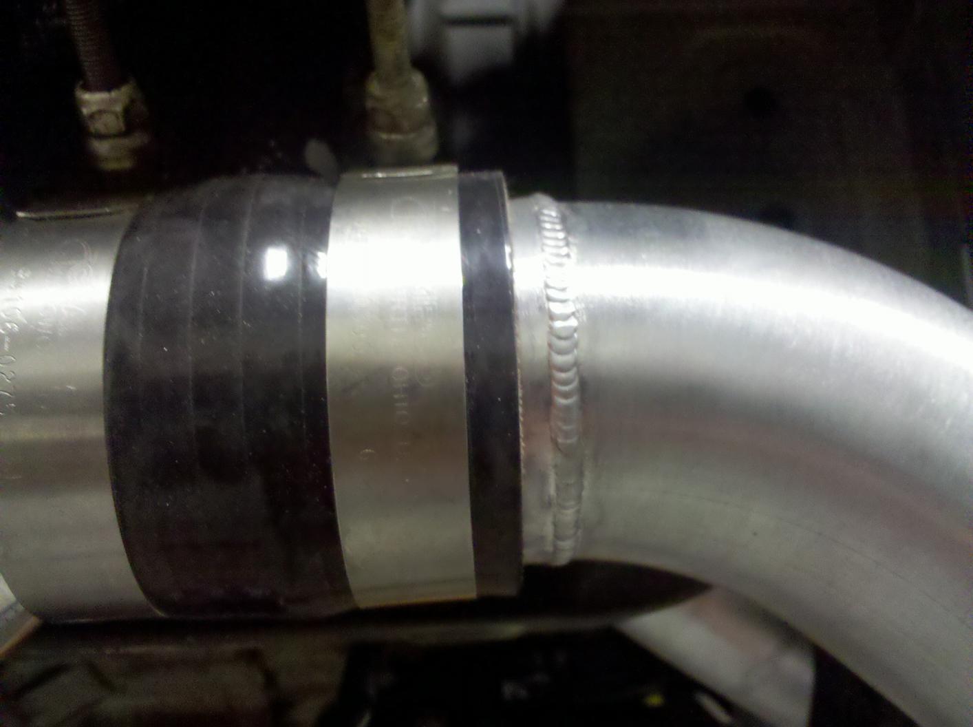

From: Buffalo, NY

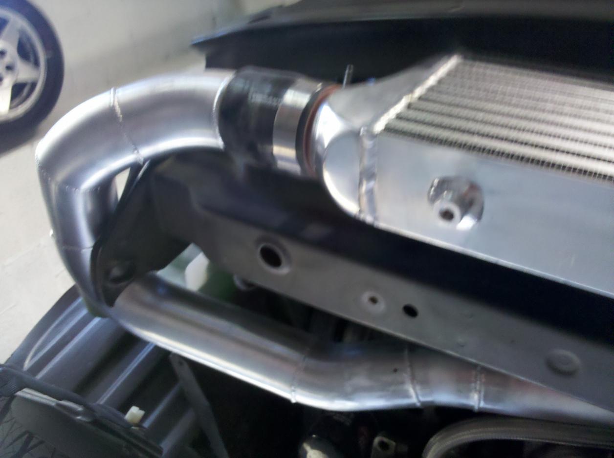

Sick - Love the time and effort put into welding all that custom piping - Nice work. Sabali pays off

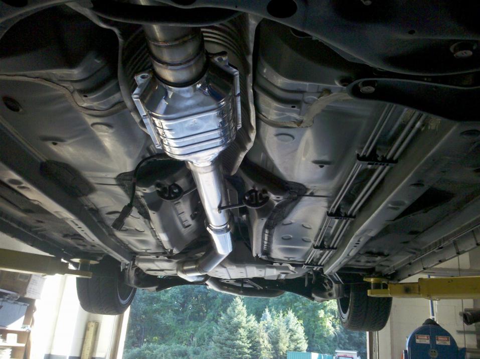

Sick setup bro holset's are wicked. Too bad you live in Jersey otherwise you could run a full exhaust with no cat's or resonator like we do here in Florida.

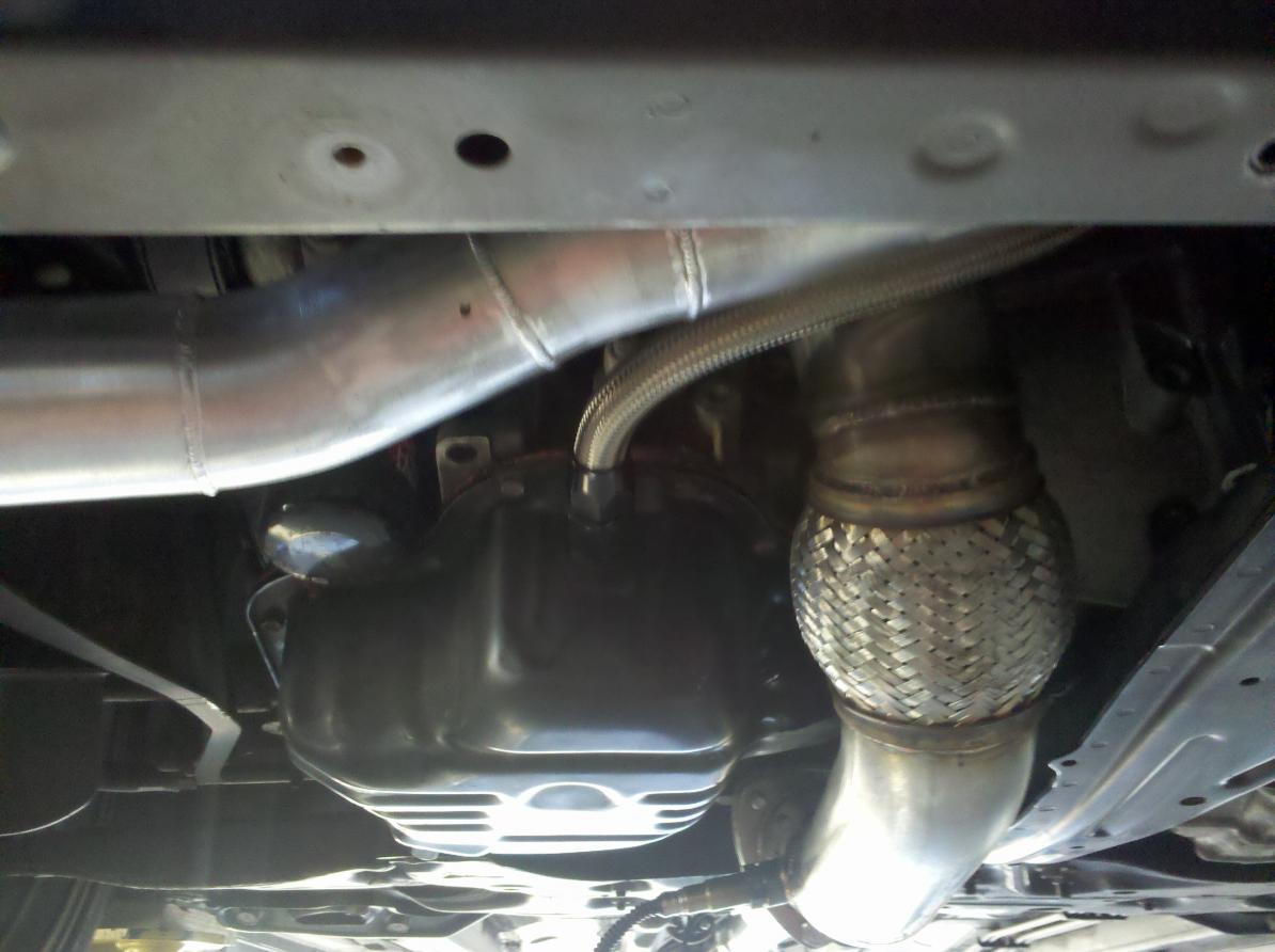

Posts: 236
Thanks dude, yea man i had to make sure i pass emissions but piping is 3" and between hi flow cat and resonator its not that restrictive. Im still getting a cell for cat bank 1 because of the downpipe, ill b putting an antifouler to see if it clears.

From: TX

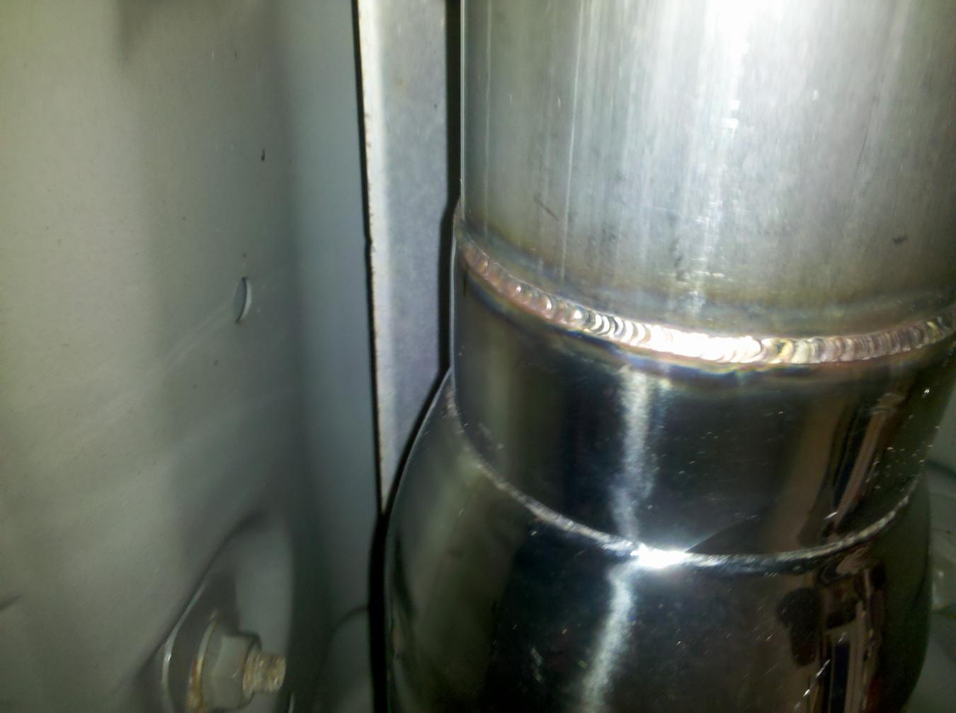

pipes and weld looks good!

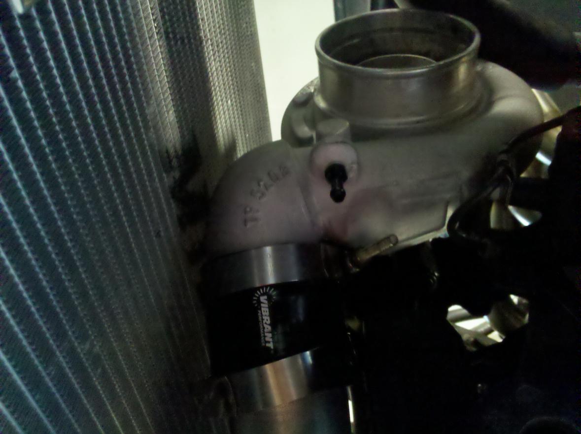

From: Manassas, Va
Is that a plastic black fitting on the Turbo Housing?
Old Oct 2, 2010 | 08:55 PM
iTrader: (5)
Joined: Jul 2010
Posts: 236
NO! LOL the hy35 comes with a little hole there so we drilled a hole, put a metal air fitting there for the wastegate n welded it in place, its kinda hard to see cuz once he welds it he cleans it real nice
