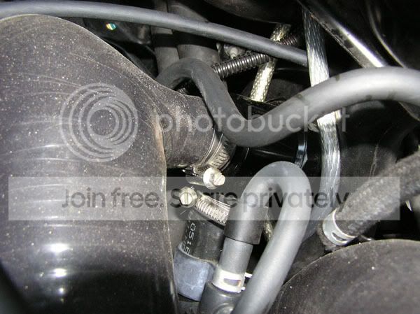

anyone have any pics or info on how to install the bosch 110 bpv on the tc?

no, but it doesn't look to hard. mostly just remove the factory airbox, and the bpv is right behind it waiting to be swapped.

loosen those 2 clamps in the middle of the pic and u get get it off.
Old Nov 14, 2007 | 12:15 AM
imsonofagun's Avatar
Posts: 1,109
From: Woodbridge, VA
easiest way is to remove the elbow piece that connects the air box to the supercharger to give you more room to maneuver. Then basically what the above person said. Note how the bpv in the above pic is oriented. There is a right way and a wrong way to put it in.
http://www.trdsparks.com/install/PTR01-21050-90inst.pdf
see page 31, figure 94
