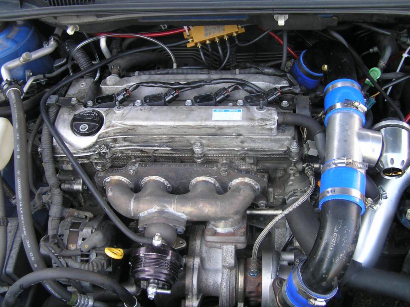

heres pictures of the kit.... the vac lines are kinda ugly

careful with that line on the wastegate there sparky. if that blew out and you didnt know, youd have major problems

lol that thing isnt coming off with out a fight lol.....but i need to get more vac line and re due it so it looks better

i think he ment how it's resting close to the engine. you could melt it. what are you using for your vacuume source?

its a bit too close to the manifold. ive melted vacuum lines like that before...not fun. are you using fuel line? cause if not, id invest in some for the wastegate. its like a few extra dollars and guarantees good heat protection.
