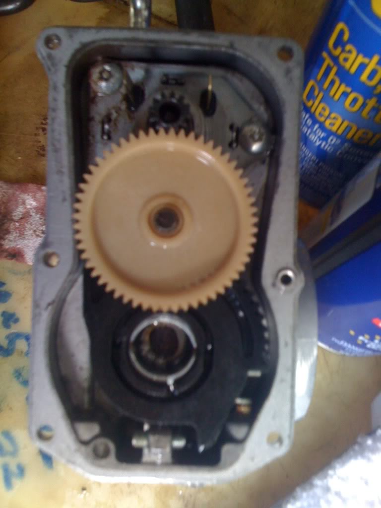

ok so i decided to take apart my throttle body and see what the hell is causing it to seize up. once i took everything off i noticed that the gear thats on the actual sensor was rusted i mean really rusty! so i took and wire brush and carb cleaner and cleaned it off and then sprayed car cleaner everywhere. then i put wd-40 in the spring and all the gears and let it soak there for a couple of hours and now its back to normal. it opens easy and closes by itself. now all i have to do is by realy tiny screws to replace the rivets i took out and then try it out. i will try it out tomorrow cause i still have to get the screws!
heres is some pictures of inside the TB.

what was rusted was the top gear on the first page.
