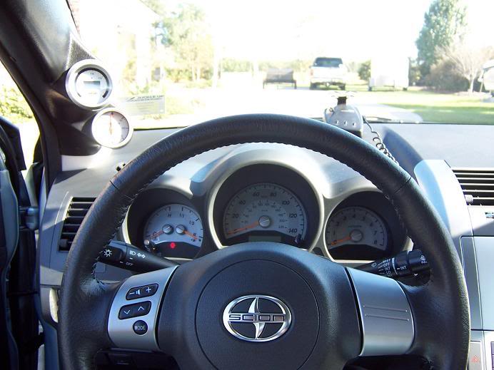

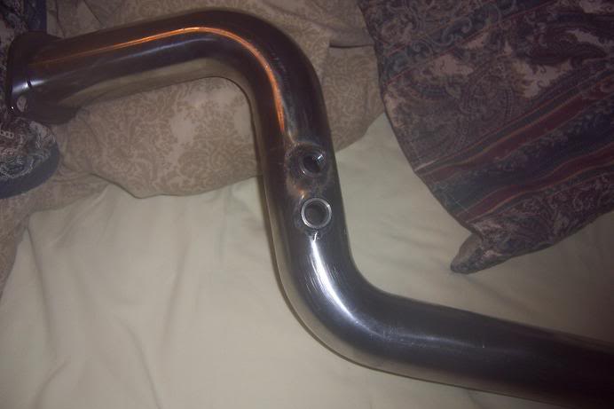

If you're using an aem FIC it will be piggyback to the stock ECU. Thus you'll still be using the stock primary and secondary o2 sensors. The UEGO or the like will be an auxillary sensor you'd want to place as close to the turbo as you can (along the downpipe or S-pipe before the secondary)(You'll have to weld in a bung). This sensor will be (if you get the UEGO) hooked to an A/F gagues (2-1/16")(comes with the kit) mounted in the cabin along with boost gauge and whatever else gauges you use. Now if you were to upgrade to an AEM EMS later there's a secondary connector on the UEGO harness to hook into the EMS which then, but don't quote me, you wouldn't need the factory sensors.
Here are some pics of my UEGO setup in my past 06 dezod powered tC:

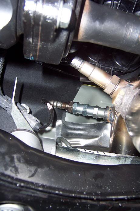

Wideband AEM sensor and secondary with homemade antifouler

You have to weld in an extra bung:

Interesting there ProtoType.... on the pic with your anti-foulers. I've ran that trick on both of my tC's. However, I see that you have it stepped out using a total of 3 of them. I've only ever used 2. So you don't have any issues stepping the sensor that far out of the pipe?

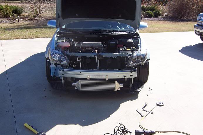

The larger turbo will not drastically change the life expectancy of your engine. You can just run lower boost. As far as mounting the intercooler, You'll have to drill your crash bar. Sorry, but it's not difficult at all my friend. This is all you have to do. Find the centerline of the intercooler, then find the centerline of the crashbar. Mark each centerline. Line them up, then mark where the mounting holes on the brackets meet the crashbar. (i used whiteout for all). Then use a drill bit slightly larger than the bolts and slowly drill through the crash bar. Pics:
You're right, i used a total of 3. 2 of which were bored out. The fouler threaded into the s-pipe was not bored. No never had an issue using 3. I was getting CEL's when i only used 2, so i used 3 and no more CELs. My tune was more so on the richer side, so reason being.

I never said it was hard he just drilled from the top of the crash bar through the bottom (going through like 4 layers of metal and his ended up a little crooked).. I'd rather mount it like you have it but I will have to make some brackets no big deal but your pics helped thanks. his just have the threads on top and no bracket.

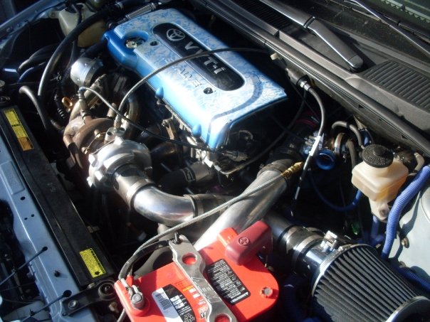

Its got the turbo, manifold, down pipe, s pipe, intercooler piping, bov, wastegate, 550 cc injectors, ingalls engine damper, gauge pod, DC sports strut bar, oil lines. Local guy is parting out his old car, moved on to a supra. Googled his name and got a couple hits for winning car shows. He was listed on here for getting second in a NOPI event in atl. Its all I need except tapping the pan, gauges, fic, and new clamps. He has a greddy ultimate but I am going with the fic.

Not a bad setup, just be sure to get a shorter oil feed line, holy crap that's too long! If you can get the Greddy Ultimate with a MAP sensor with a PNP harness cheaper than the FIC, don't be afraid to use it. I know a few boosted TC's personally that run perfect on them with a good tune. They actually run a little smoother and closer to "factory boosted" than the FIC. It's just usually more expensive to get and tune than the AEM. I use an FIC myself so either choice is a good one in my book, just trying to save you a few bones.
