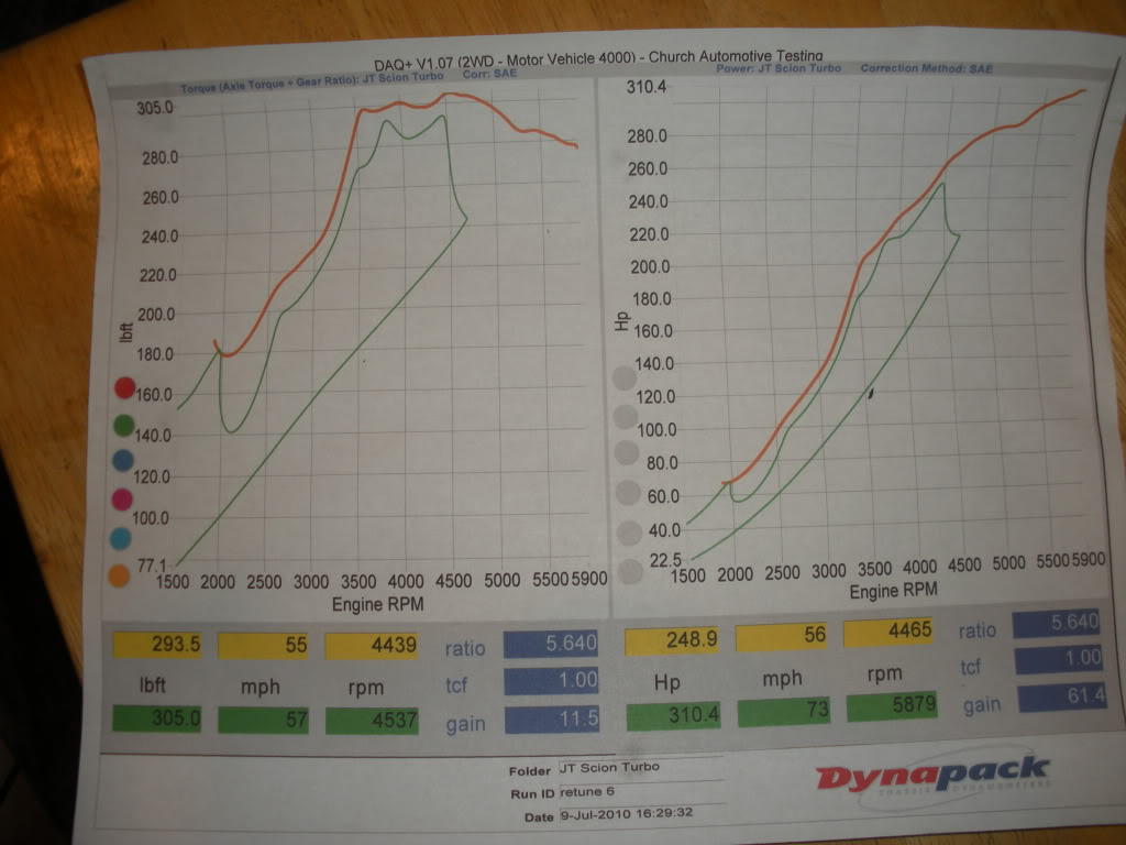

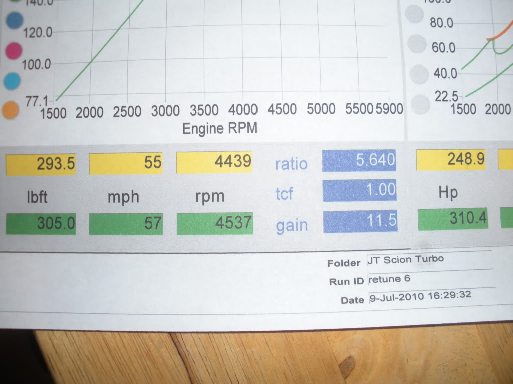

I am running 11.6 psi and made 310 WHP, my tuner said I need to make an intake for the turbo, because its sucking in nothing but hot air. He put a fan on the filter and did a pass and made 26 hp on the run. Ill post new numbers when I make the intake and get a retune.
The baseline Dyno was cut short because the tuner thought it was over boosting, he didnt know i was doing 11+ psi

crush02342002's Avatar
Posts: 11,271
cool!!
me likey!!
hows the car feel?
dyno looks a little goofy (talking about the dips on the top end)

Originally Posted by crush02342002
cool!!
me likey!!
hows the car feel?
Idle sucks, and starting the car takes forever. Hes going to fix these issues when I get it retuned for my intake
but cruising and WOT is insane. This turbo spools sooo fast, it blows my mind

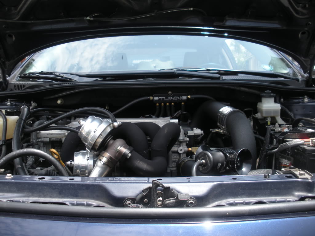

is that a one off tt mani? never seen that one before. good stuff though. bout time for some new tires.

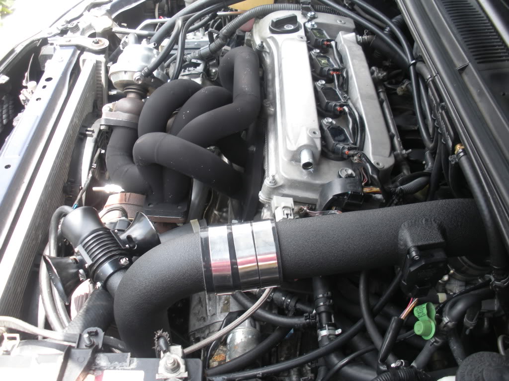

also i just gotta ask. why 3 t-bolt clamps on one coupler?
That clamp broke off while it was on the dyno.
Lucky for me I had extras in the car so I threw 2 on there just to make sure it wont pop off lol

is there a reason why you dump air before the MAF?

Hp looks smooth to me..
Because my last kit was a draw thru setup, and ran like ___
Then i seen Ptunings kit, and everyone said how well it runs, so I copied what they had going on lol. And it runs great

God damn is that a bov or a train horn. It's big as hell! Wither way setup look real clean. You should weld those 2 pipes together so you won't have that coupler an 3 clamps. Other then that congrats on setup and dyno.
Haha ya the BOV is loud as hell
Ya I will eventually get those pipes welded

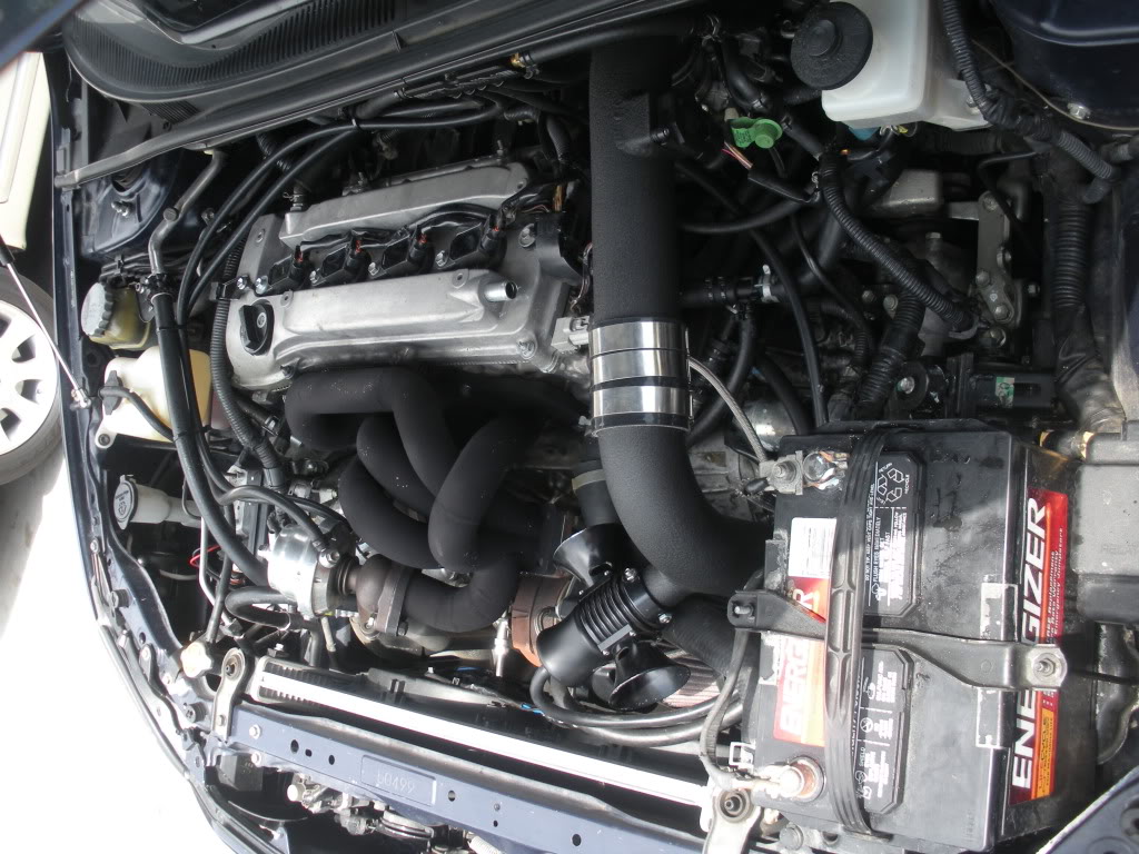

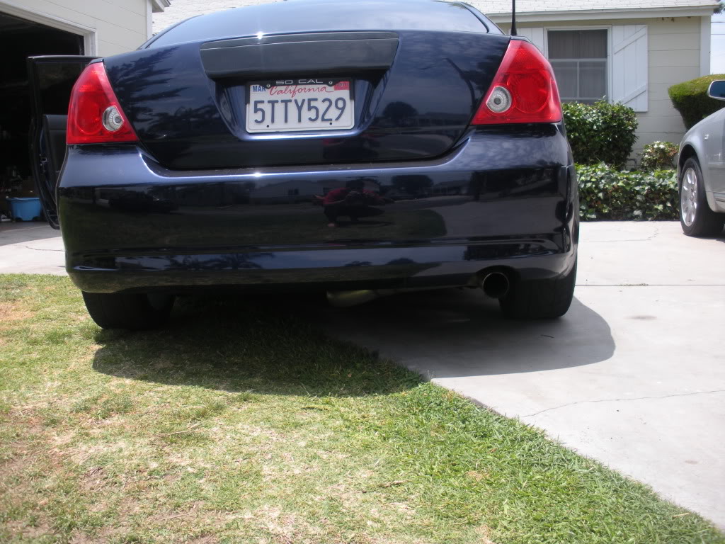

no pics of the intake problem?
Not really a problem, you can see my filter is connected directly to my turbo, thus sucking in hot air
