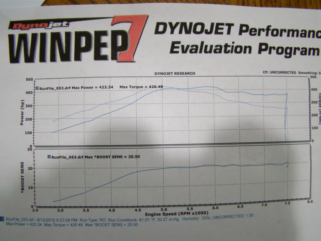

No problem Paul You know I love you guys!!! Car made 423WHP and 20PSI before variable valve timing was tuned, Ill take a pic of the graph tomorrow.

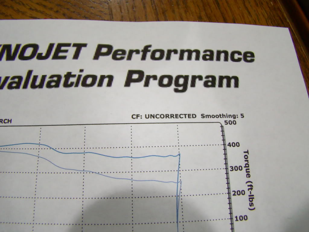

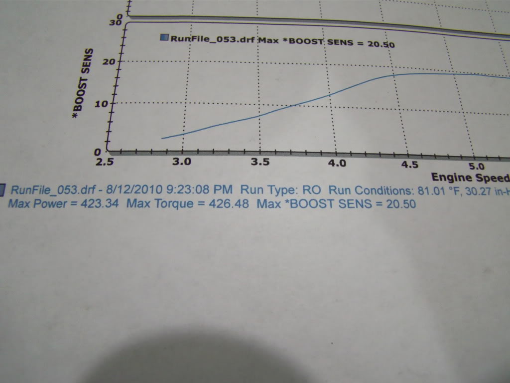

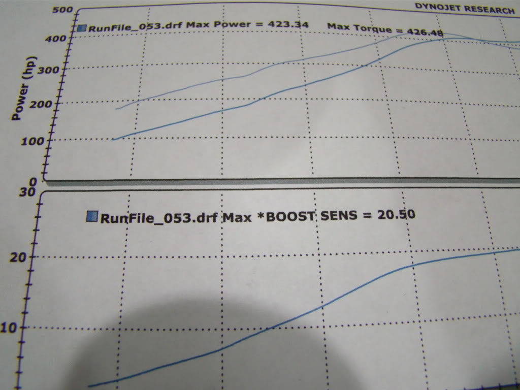

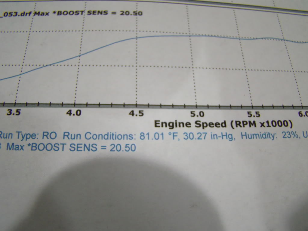

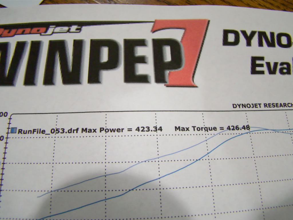

Pics of the graph:

Musta been a soft tune. There is a lot more power left in that setup after viewing the curves.

For the most part considering it was on C16 Race fuel which allows for alot of agressivness. PLUS we had not even touched variable valve timing in the hydra which is good for 70 WHP at the same boost level The map was zeroed out pretty much hehe ;) The run in which the rod went through the block I was making this same power at 4700 RPM's on 22 PSI ;). But I wont post that map since its dirty.

that dyno gives me a chubby. great work i cant wait to see where this goes.

how much timing are you running at 5k and 7.5k? the hp should not be falling past 6k.

He's on stock cams and lower compression. They do not breathe that well above 6K.

Ill never give out timing numbers. Also in that post I did say that was before we had tuned the VVT-I which is good for 60-70WHP. BTW this car is run on a Hydra Nemesis.
