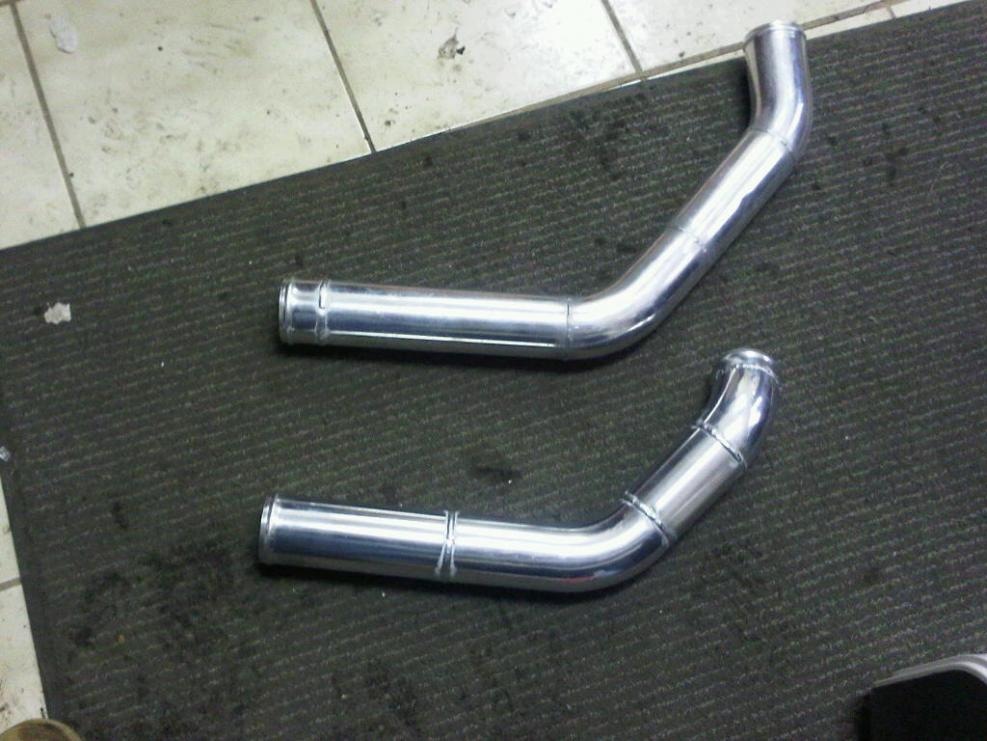

Attached Thumbnails DEZOD MOTORSPORTS: ALPHA SERIES V-band Manifold Installed (Page 21)-img00190-20110121-1148.jpg
Old Jan 21, 2011 | 03:56 PM
  #398
paul_dezod's Avatar
Scionetics
KAD
Posts: 11,936
From: Western NY
More to come.
