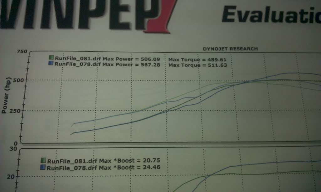

All Done
This is done with a non sleeved block, Stock throttle body, Stock Intake manifold, stock Cams, and Stock Coils

good numbers. checked out the car on youtube and it sounds sick. i would pull a little timing at and before peak boost though. the 24psi run looked like you were getting a little knock around there, and that is the last place in the powerband that you wanna see knock. can't wait to see some track vids of this beast.

No you tube video from yesterday. I do have a video it just isnt posted yet. Also there was zero knock recorded by my hydra 2.7, the fuel being used is C16 VP race fuel. This was achieved on a non sleeved block with stock coils, stock cams, stock intake manifold, and stock throttle body. Motor is a built with carrillo H beams, custom cp pistons, acl main and rod bearings, ferrea 1mm oversized valves, with ferrea springs/seats/and retainers, head was ported and polished by Vinny Ten.

the vid i saw was just a startup vid. sounded like it was cammed. no knock huh. maybe you were just slipping the rollers or something, cause there is a noticeable dip in power on the blue 24psi graph. time to get some lard-asses to sit on the fenders whilst on the dyno.

Tire slippage on the dyno can sure be deceiving on power curves and tuning.
