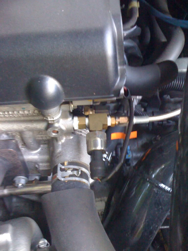

I'm tapped off the block with one line going to the turbo and one line going to the gauge, I don't even have the stock sensor plugged in lol.
Like zat. Connector goes to the oil pressure gauge, line goes to the turbo, and that's it. Simple and clean. Also, almost 1 year of boost and not even the slightest sign of leakage :D.

wait wtf? which one is ths stock sensor?

The one that isn't plugged in. I never bothered plugging it in...never had any problems, no CEL...nothing lol. The connector is just sitting around somewhere.

Carbon, that's exactly how I have mine except I have the factory one plugged in too. So I have the one for the turbo, factory switch and electronic sender for the prosport gauge. That's why I know for a fact something is either wrong with the sender or the gauge.
