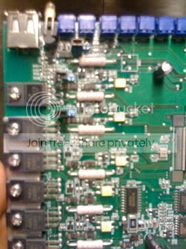

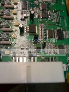

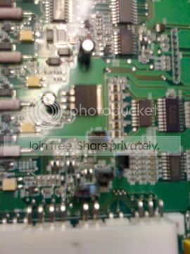

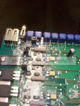

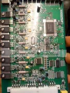

haha uploading now.
Old Aug 6, 2008 | 06:35 AM
java09's Avatar
Posts: 6,187
From: You All Ready Know_..
heres the bottom:
top:
whole thing:
this should tell you if this was your problem.
lemme know!

so were the jumpers wrong?
these should be the same as the dezod jumpers.
