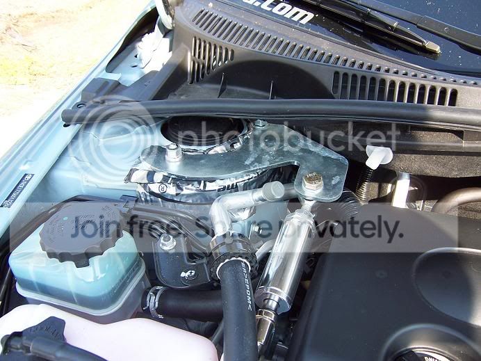

Originally Posted by zer0
I had dynamat, and still had noise... its a noisy little beast.
From that pic, yes, still a slight bit of noise, but now, i have completely covered the bracket in dynamat , dynamated that part of the passenger strut top mount and added a wrap of it around the dampener itself. No noise now.

Note: make sure to put a rubber fitting over that P/S Line it rubs up against the stiffy. check GOLDSBORO pick.
